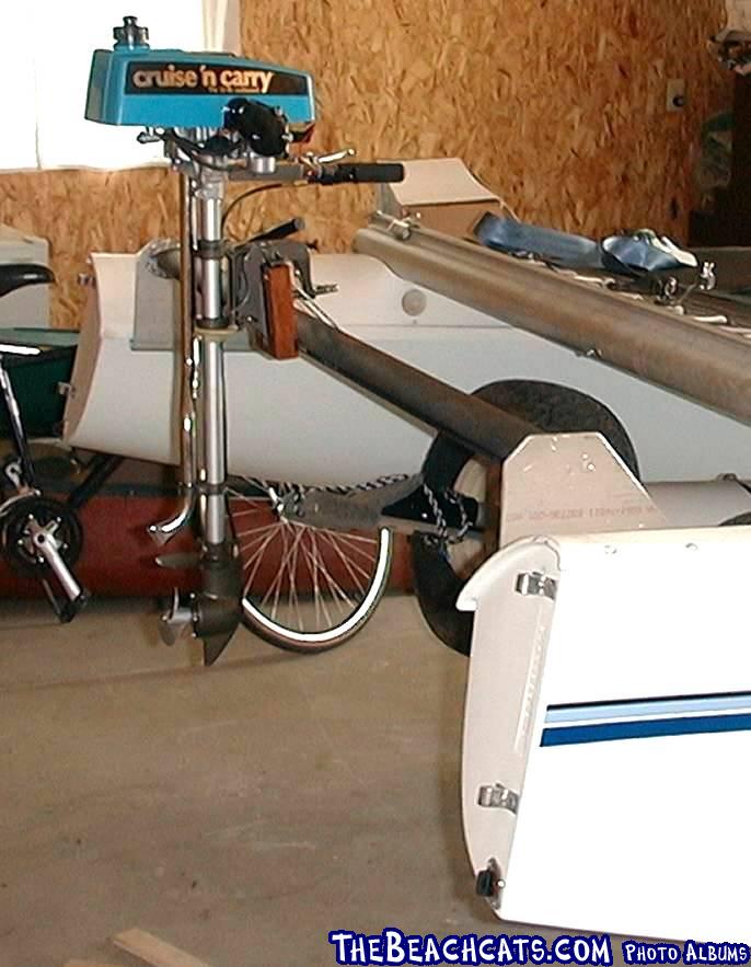

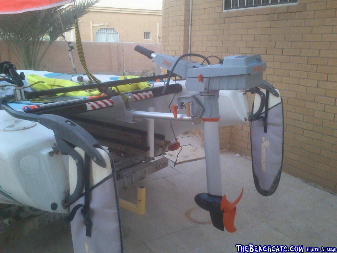

  • Deluxe motor setup, Cheata mount and Torqeedo (this is a $2,000+ setup)
    http://www.thebeachcats.com/gallery2/main.php?g2_view=core.DownloadItem&g2_itemId=83117&g2_serialNumber=3
    Cruise and Carry on custom mount (kind of thing you can do if you are a machinist)
    P18 mods
    http://www.thebeachcats.c…pictures?g2_itemId=17934
    That Cruise and Carry used to be the hot setup but I don't think they are available.

  • looks cool but that's the cost of my boat almost. I'll save that for the $10K boat...but there's some nice engineering involved with the mounts to pick up some ideas for a cheaper setup on my Prindle 19. How much is that Torqueedo w/o mount? I looked at the video, it's great that their engines are submersible and solar chargeable. That goes a long way towards justifying the high cost....be interesting to see how the rates of charging and depleting at low speeds add up to net depletion or charge of the battery under a few real life scenarios...e.g. 20nm trip with average sunlight, no wind, no current etc...
