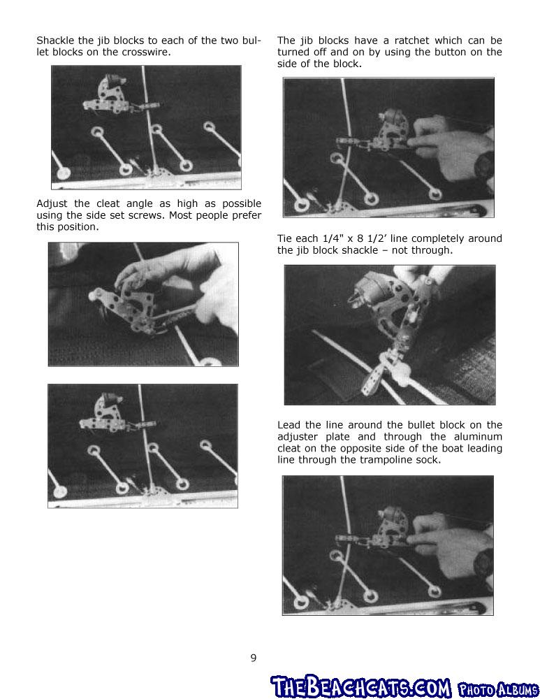

  • Quick view of manual pages here
    http://www.thebeachcats.c…pictures?g2_itemId=35451
    sample
    http://www.thebeachcats.com/gallery2/main.php?g2_view=core.DownloadItem&g2_itemId=35489&g2_serialNumber=4

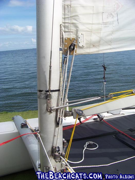

  • Here's a pic of the downhaul on my P18-2
    http://www.thebeachcats.com/gallery2/main.php?g2_view=core.DownloadItem&g2_itemId=76155&g2_serialNumber=4
    The jib halyard is stored behind the zipper of the jib, its in the manual.
    The main halyard is stored in the small zippered pocket on the tramp,
    and should not be cleated or run trough a block.
    Wise choice you made not using the 4-way system, it ruins your knees,
    and sailing-suit.
    You can ad a zipper on each side of that pouch and use it for extra
    storage.
    Regards, André

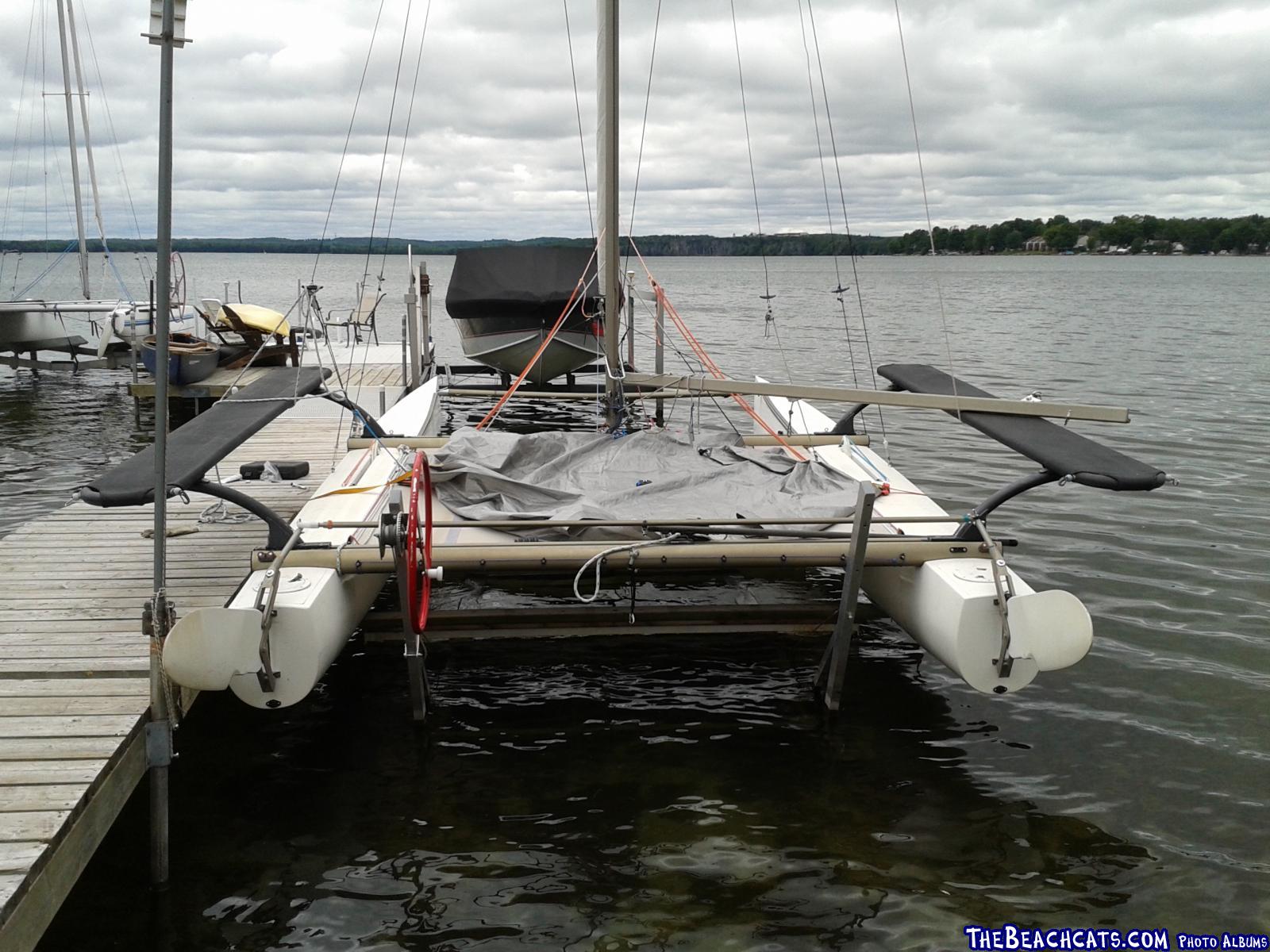

    Make it look like this,(click on photos to enlarge);
    http://www.thebeachcats.com/gallery2/main.php?g2_view=core.DownloadItem&g2_itemId=109430&g2_serialNumber=3
    The red lines are the jib lines, you can see how they terminate via a short line attached as per davidsd above.
    Remember, each jib line is a 2:1, & you have 2 of them. For every 1' you make that lead from the jib clew, you save 4' of jib sheet. There is a limit as you need to be able to fully sheet the jib before the small block runs into the jib block on the hull.

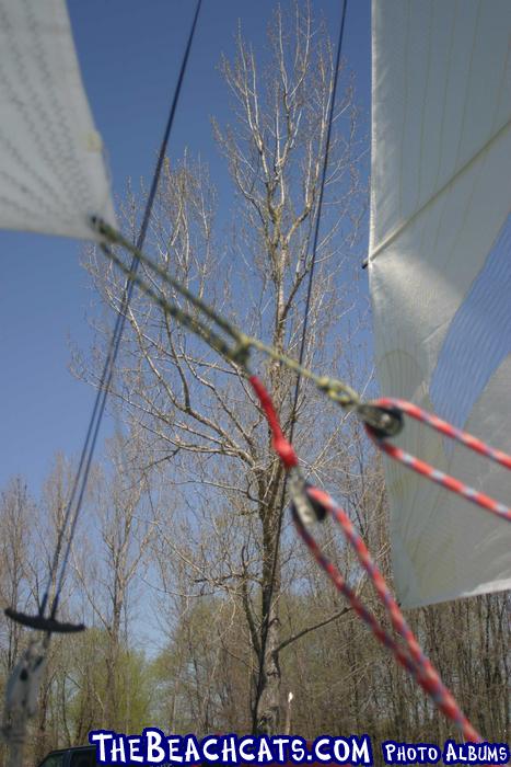

    A better way, IMO is to attach like so:
    http://www.thebeachcats.com/gallery2/main.php?g2_view=core.DownloadItem&g2_itemId=109574&g2_serialNumber=4
    This is how the Mystere 6 is rigged. the bottom line that goes to the clew is actually a long loop, the other line ends in a monkey fist. You put the end of the loop through the clew, then put the monkey fist into the loop, presto, jib attached with no knots or shackles to undo.

  • Nice Wings! Are those custom or is that an option on the Mystere?

  • They are Hobie 21 wings, modified to fit the Mystere. If you can drag them in the water, you are already on your side.
    They install, or can be removed, in about 3 minutes. It takes longer to walk to the garage & get the socket than to take them off.
    http://www.thebeachcats.c…ictures?g2_itemId=109394
    The Mystere XL's could be ordered with a factory set of wings, but I have not personally seen them.
