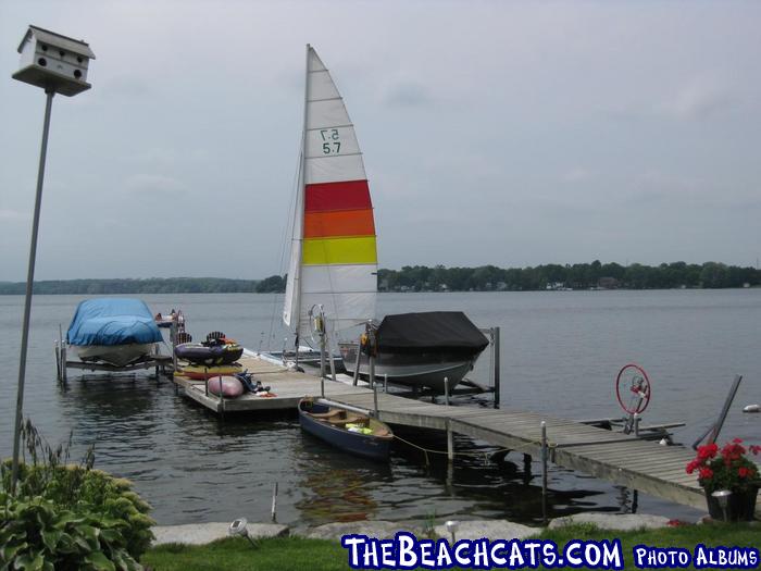

  • QuoteMy other and possibly better option is to paddle to a beach about 75 yds away and raise on the beach.
    Depending on the wind/current/water depth, that could easily be your best bet, especially if you only have to paddle off the dock & can then walk it. 75 yds is a very short distance.
    I tie up to a dock many times per season. I own the dock, so admittedly, that eliminates most of the aggravation. We often sail from the house to some parks, & tie up to their docks. If it is a straight dock, with ramp on each side,the lee side is preferable. Depending on room you can let the boat swing into wind, pointed at dock, held by a line looped, not tied to something on the dock. Sail is now easy to raise. When ready let the boat drift back,slip the line, & sail away. A furling jib is your friend at docks.
    I have a couple of premade lines on the 5.7, one on the bridal, one from a small tab I added under the head of a bolt on the rear beam. The 5.0 ties one onto the pintle pin. Depending on the particulars of your dock you might make some up.
    I have a couple of partial pool noodles with some line tied to them. They can be stuffed into a hatch. My buddy puts a full pool noodle just under the flap at the rear of the tramp, parallel to the rear beam. The tramp lacing keeps it in place, secured with a couple of small bungee loops he made up. A couple of small boat fenders could also store there.
    If leaving the boat at the dock for any length of time I use 2 regular boat fenders. The size will be determined by the dock you use. Some docks, with smooth wood/concrete sides you can get by with tiny fenders. If the dock is corrugated or open truss, it is more difficult.
    The 5.7 & 5.0, as you know are uncluttered platforms, easy to stow fenders. If you have double traps & are solo, you can hang the fender from the front dogbone & loosely tie the other end off at the bridal,shroud or hiking strap, it won't get in the way of the jib. You can also tuck them under the front end of the hiking strap & secure. Perhaps a padeye on the front beam for tying.
    Your dock will dictate how much line you need. One Provincial Park we sail to requires more line, I tie one line to shroud, the other to bridal,with fender in middle & just let the fender hang partially over the hull. I used to use another short line & run it around the hiking strap, to keep fender on the boat, but it really wasn't required.
    I have on occasion just dangled it from the front dogbone & let it bump around, the trap bungee keeps it mostly in one place, tuck the fender line into the tramp pocket, or wrap around the front of hiking strap.
    One last item, unless your rudders lock up, SECURE YOUR RUDDERS in trail position while at dock. If you don't they will end up damaged, especially if the dock uses open truss beams.
    I have a short bungee with "S" hooks that I keep slightly stretched on the rear tramp lacing, under the flap. Undo one end, go around tiller tie bar with some tension & snap back onto tramp lacing. Just remember to undo it before casting off, it can be exciting in big wind to suddenly be fighting to steer.
    http://www.thebeachcats.com/gallery2/main.php?g2_view=core.DownloadItem&g2_itemId=75954&g2_serialNumber=6
    Edited by Edchris177 on Jun 22, 2014 - 12:24 PM.

    PERFECT. THANK U ! icon_biggrin icon_biggrin icon_biggrin icon_biggrin icon_biggrin icon_biggrin icon_biggrin icon_biggrin icon_biggrin
