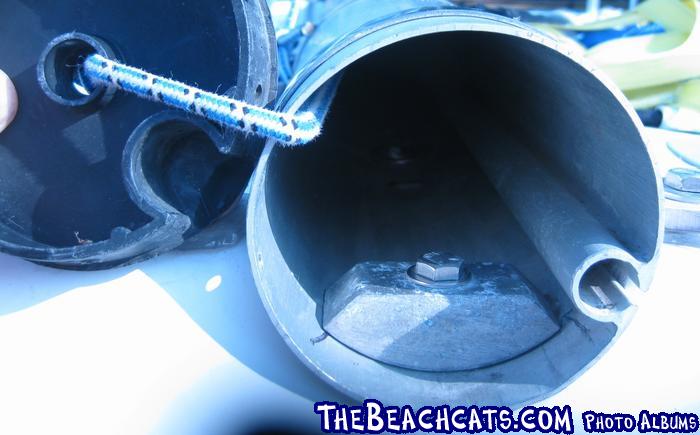

    You would need the upgraded one of those, (fairly easy to source, I have several, Pete Begle or Dan Berger may also have them, depending on where you are in the country) + the DS casting,(saddle) that sits on the V brace, that the DS rod sits on. You can see it in photo 3 of the 2nd album. Here are all of the parts. Murrays sells a kit with everything you need, make sure it includes the compression tube.

    Does your boat have the half moon chocks inside the ends of the beam? They prevent the beam from rotating. I have seen some earlier models that didn't use it. Many have drilled 2 holes in each bean strap & installed an SS rivet, does the same thing.

    Ed, The information that the V brace needs to be replaced is enough to make me just do a simple replacement of the 1/2" shaft for now. Thank you for those links. The boat does have the half moon chocks, which seems a nice design solution. Hull design is what drew me to this boat and I am finding lots of other good things now that is entirely disassembled.
