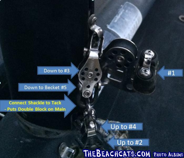

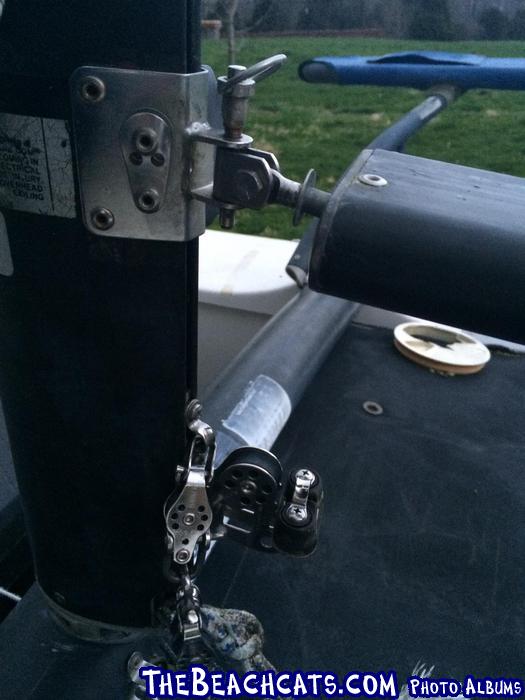

    Please see the image below. This is on my "new" H18. I am guessing this replaces the stock downhaul system on the H18. How do I thread this / connect to the tack of the main.
    What's the purpose of the single block connected to the tie strap? Double blocks connected to single block?

  • timscottyoungSailors,
    That looks like the bottom of the "H18 Power Downhaul" (5 to 1)
    http://www.murrays.com/07-2087.html
    So look around in your parts and see if you have the top piece. Then you just need some very low stretch line to complete the system.
    http://www.murrays.com/mm5/graphics/00000001/07-2087.jpg

  • Maybe just a double block witth a becket that attaches to the bottom of the sail.
    http://www.harken.com/productdetail.aspx?id=5157&taxid=424
  • beachsailorMaybe just a double block witth a becket that attaches to the bottom of the sail.
    This reply got me to thinkin'...
    Using the hardware in the original photo, I came up with this application/routing... see photo. Will this work? Is this a 3:1 purchase? I'm not sure you use that word here.. icon_confused
    http://www.thebeachcats.com/gallery2/main.php?g2_view=core.DownloadItem&g2_itemId=107833&g2
    Tim Young
    Hobie 18' + other stuff that floats and goes.
    Kentucky
  • What you've shown (double block on the tack) would be a 4:1 purchase. This is OK on the 18 and was the max that was allowd by the class rules for many years. The class rules now allow up to 8:1 purchase and allow two exit blocks so the downhaul can be trimmed from the side of the boat while under way. For casual sailors it is probably overkill, but for more serious sailors and racers, it is definitely a noticable improvement.
