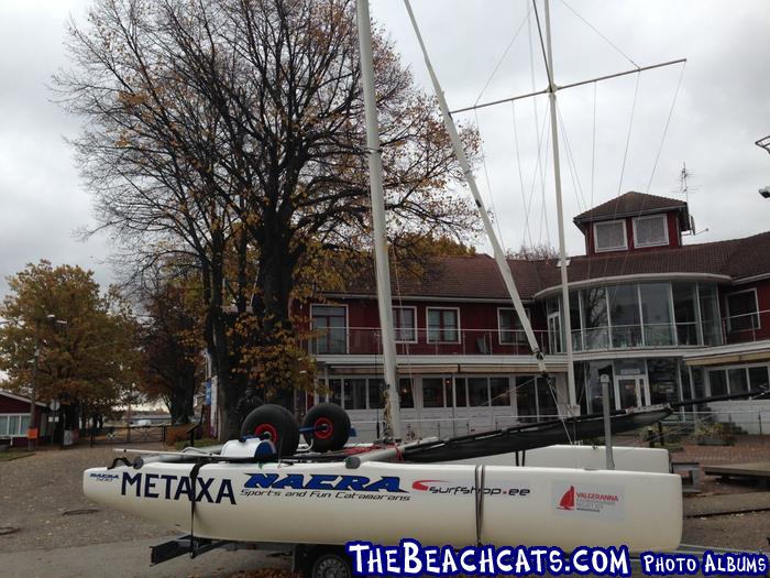

  • Here is a photo of the boat, taken by the seller.
    http://www.thebeachcats.com/gallery2/main.php?g2_view=core.DownloadItem&g2_itemId=106356&g2_serialNumber=4
    Created a photoalbum about it, as I will be asking for help as I work on her: http://www.thebeachcats.com/pictures/?g2_itemId=106353
