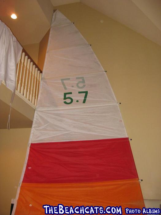

    When I first got my 5.7, I put an anchor & small Harken block up near the ceiling of the lake house,(20' ceiling) & hoisted the sail. My theory was, A) it would look good, B) cover a very large vacant wall, & C) we don't use the place much in the winter. They were all good points, but wifey overruled them all, so I put up a 4' wide x 10' shelf in the garage corner, 3' down from the ceiling. Leaves me enough room to push the power boat on trailer under it, & I can still get at them for whatever reason.
