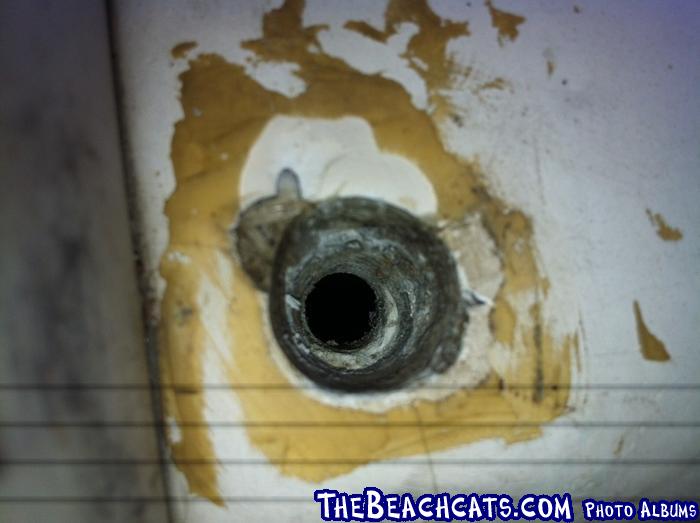

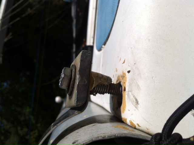

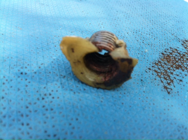

  • Upon closer inspection, it appears that a previous owner glued a threaded sleeve into the bolt hole, which subsequently pulled out when I tightened the strap bolt. Does it make sense to drill/tap a larger hole and epoxy in a length of threaded aluminum stock? I could then drill/tap a standard sized bolt hole into the aluminum stock. Or is this just another stop-gap, half-arsed "fix"? Do I need to suck it up and whip out my Sawzall? My only concern doing this is that I don't know how large a hole I will have to cut into the fiberglass and I am completely inexperienced in fiberglass repair. I am attaching a few pics of the damaged strap bolt. Thanks for your help!

  • Email me, I did this repair on the ARC22 last season, with a ss nut welded to short PC of ss strap. Enlarged the hole just enough to insert this piece vertically, pulled it into horizontal position with wire, and secured it with thickened epoxy and 8-32 machine screws. Very effective and permanent, I think I have pics of the repair.
