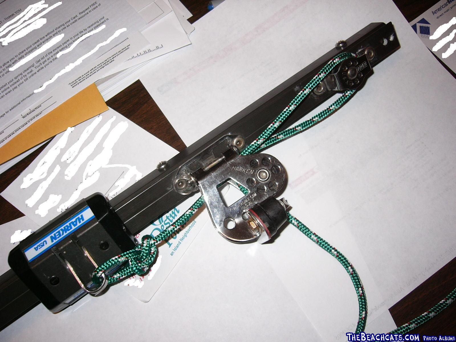

  • clew traveler from a Nacra 5.8 mainsail.
    http://thebeachcats.com/pictures/?g2_itemId=105784
    you asked if they work well? yes, quite well in controlling the power in the sail.
    j
    Edited by arch on Sep 21, 2013 - 10:10 AM.
    '99 Nacra Inter20 (sold)
  • The pictured clew traveler has been modified. The Nacra supplied set up has a Harken 140 pivoting exit block.
  • Might want to give this guy a call. It looks like it is missing the pivoting exit block, which you can buy anywhere.
    http://www.thebeachcats.c…cra-catamaran-parts.html
    I added a picture of mine so you can see details.
    http://www.thebeachcats.com/gallery2/main.php?g2_view=core.DownloadItem&g2_itemId=105791&g2_serialNumber=3
    If you are getting a new sail, you will need this. If you are going to add it to your existing sail, you will have to modify your sail by adding a bolt rope. Even then, you might run into problems because the sail thickness will make it difficult or impossible to slide the traveler on, which has a very narrow slot.

  • QuoteThe pictured clew traveler has been modified. The Nacra supplied set up has a Harken 140 pivoting exit block.
    well go figure.........i have two different sails, from two different sellers set up this same way.
    not trying to be perfect here.....just illustrating what it looks like to those who've never seen one.
    j
  • Arch's photo is how they were in the early 90's
    http://www.thebeachcats.com/gallery2/main.php?g2_view=core.DownloadItem&g2_itemId=105785&g2_serialNumber=4
    Philip's is from the mid 90's

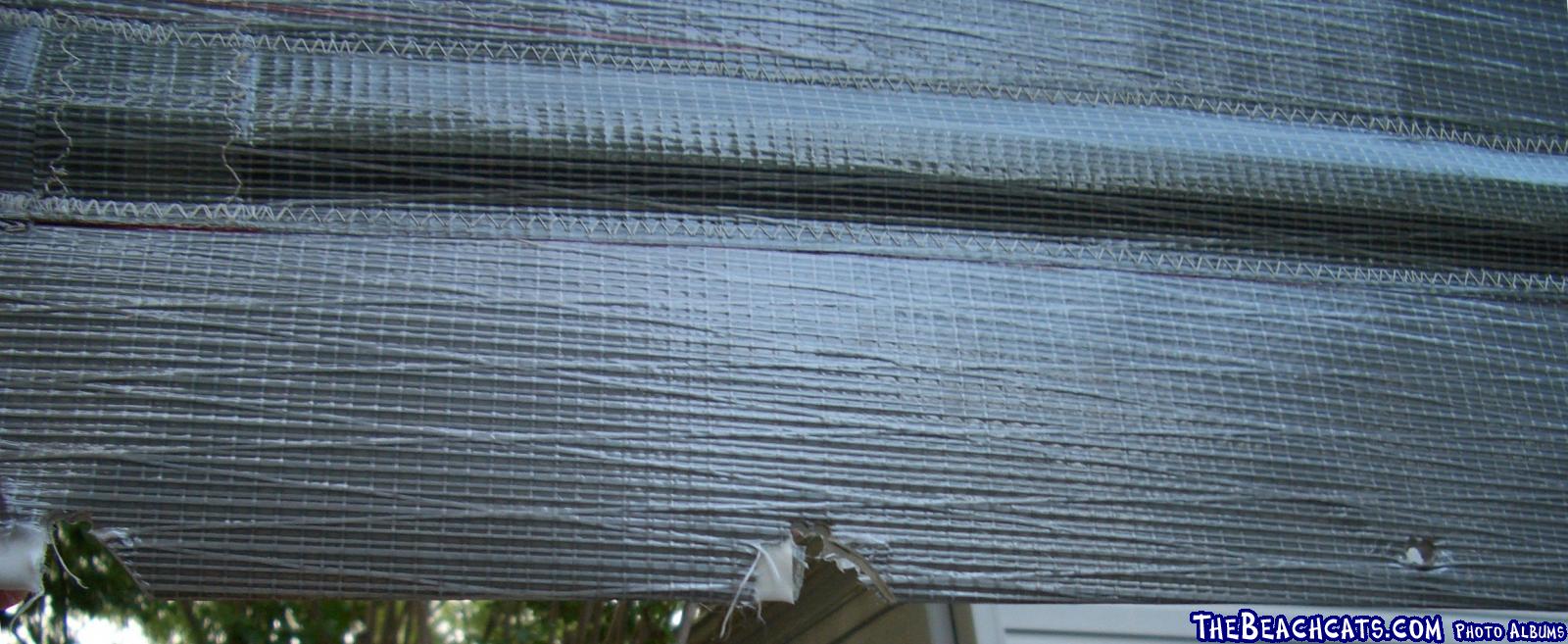

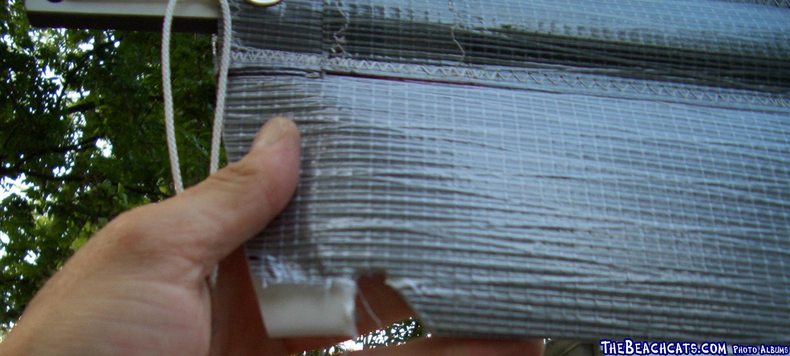

    Using the seller's included piece of sail's "foot" as he has pictured, might work on your old sail, if there is enough surface area to sew it together, and not interfere with the "plate" if there is one (see Note). You should buy the track before I do, as they are rare, and it is a bargain. icon_wink
    Note: The more modern sails that EP built used a plate instead of a bolt rope. What the seller has might include the plate. The modern cloths (PE series) "wrapped" at the foot, and the plate was inserted (slid in from the leach side) and the bolts went through the track, cloth and plate, and the plate transferred the load to the sail.
    Give me a moment and I will add a photo which will help illustrate much better than a thousand words. Either way, you will need to have a sail shop or other source, work on your sail.
  • Here are some pics (plate version, not bolt rope) of what I was describing above. This might be what the seller has, who BTW, is a top notch seller. I have purchased from him.
    http://www.thebeachcats.com/gallery2/main.php?g2_view=core.DownloadItem&g2_itemId=105798&g2_serialNumber=3
    http://www.thebeachcats.com/gallery2/main.php?g2_view=core.DownloadItem&g2_itemId=105799&g2_serialNumber=3
