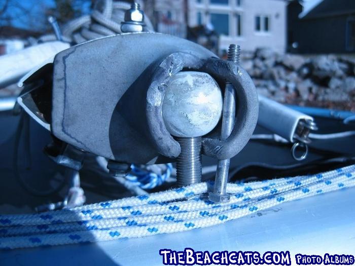

    QuoteI am missing the pin that goes thru the mast base to hold it onto the ball whilst raising it, is that a special part or a generic dinghy fitting / pin
    I have used a short screwdriver, a 1/4" bolt, a 6" landing gear safety lock pin from a jet, & even the actual pin. The cheapest,(and it works just as well as the real pin) is a 1/4" SS bolt.
    The real pin has a hole drilled in it so it can be attached to the mast, ensuring you have it handy when you need it.
    The downside of the bolt, is you have to remember to rotate the mast the correct way when you bring it down. IF you go the other way, you cannot remove the bolt. In this photo I turned the mast the wrong way. I didn't have any help, I went to the garage & got the bolt cutters.
    http://www.thebeachcats.com/gallery2/main.php?g2_view=core.DownloadItem&g2_itemId=80849&g2_serialNumber=6
