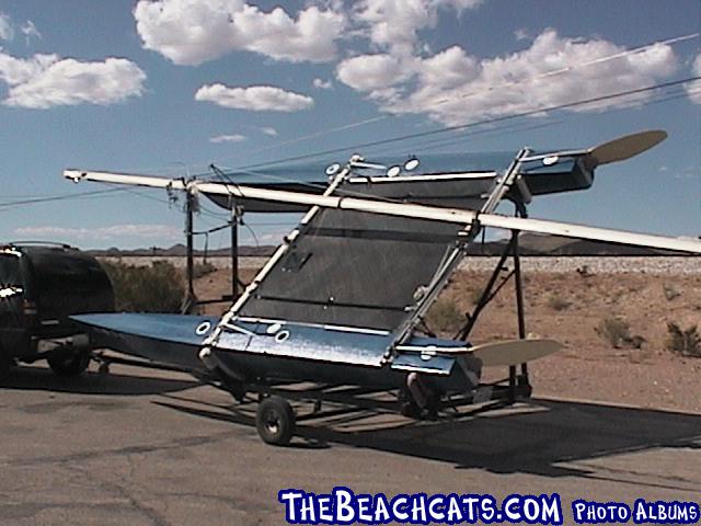

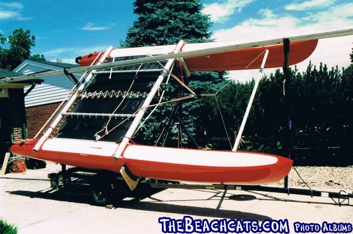

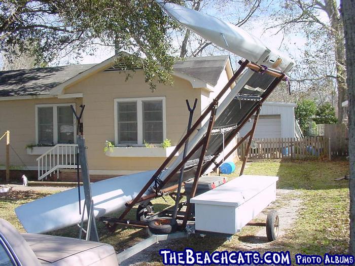

    It's all about trailering. In the US there is both a federal max-width of 102 inches (2.6 meters) for commercial vehicles and then each state has their own law. In every case but Hawaii the states use the Federal guidleline of 102 inches.
    That's why you end up with three high performance racing classes that all have about the same width despite being 16, 18, and 20 feet long.
    F16 = 2.5 meters or 8 feet 2.43 inches
    F18 = 2.6 meters or 8 feet 6.36 inches
    Nacra 20 = 2.6 meters or 8 feet 6.36 inches
    There have been wide beachcats, the famous Tornado was 20 x 10 feet, and recently Nacra introduced the Nacra 20 Carbon which is 20 x 10.5 feet, and then there were the 18 Squares which were very wide because they were a single handed class with very few rules.
