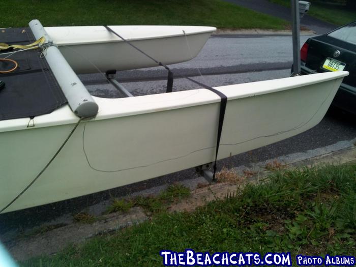

  • Lots of soft and crunchy in the p15 I just picked up. black grease pencil outlines areas affected.
    The last shot is from inside the inspection port or the port hull and on the right you can see the deformation of the layers separating. Has anybody repaired one from the inside out?

  • fill her up! start at the bottoms and work your way to the top. you have nothing to lose...mayby 35$ in resin.
