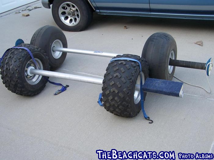

  • very impressive. i thought about doing something similar but settled for this setup.
    http://www.thebeachcats.c…ictures/?g2_itemId=82521

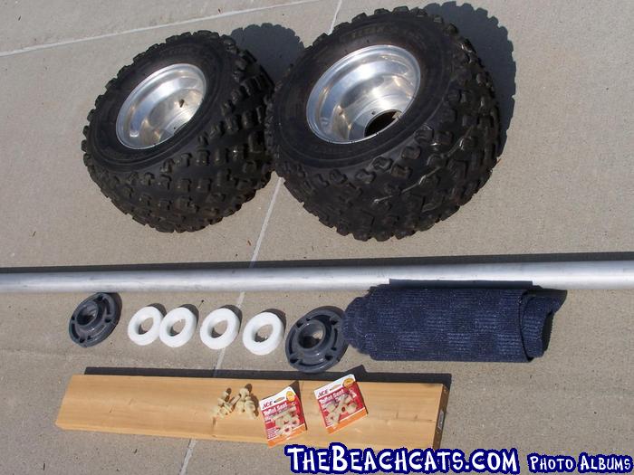

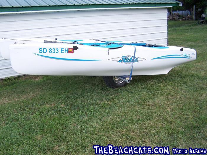

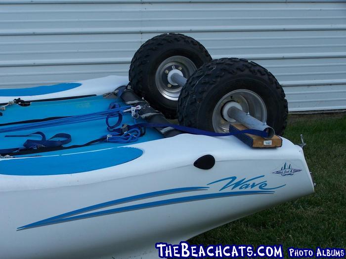

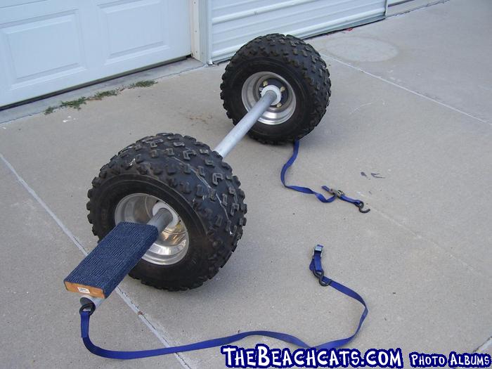

  • Was fascinated with Carolinacatamarans beach wheel build. I faced a similar situation after selling my NACRA 5.0 and picking up an awesome deal on a '06 Hobie Wave. (Time to teach the grandkids how to sail) I didn't like the fact that my fullsize beach wheels would rub the inside of the Wave hulls and started to gather pieces to build a scaled down version. This is what I ended up with:http://www.thebeachcats.com/gallery2/main.php?g2_view=core.DownloadItem&g2_itemId=103163&g2_serialNumber=3The tube is an Alcoa 6061, 2.25ODx .083 wall I picked up years ago for about 30 bucks (I think they are around 80 bucks now so maybe a piece of conduit would work). The wheels are Fast Trekker 22x11-10 ATV tires on aluminum rims with 3/8 four hole bolt holes. Got them from a local motorhead for 25 bucks. The flange is a schedule 80- 2" socket flange @ $4.95 each. There is a lip on the inside for a stop that I carved flush with the sidewall. The "lug" bolts are 3/8" plastic toilet seat holdown bolts. The holes in the flange are larger than the wheel holes but the rounded nuts center the flange perfectly. The white washers holding the flange in place are cut out of plastic cutting board materiel.http://www.thebeachcats.com/gallery2/main.php?g2_view=core.DownloadItem&g2_itemId=103166&g2_serialNumber=3 Construction was sraightforward with careful attention paid to wheel spacinghttp://www.thebeachcats.com/gallery2/main.php?g2_view=core.DownloadItem&g2_itemId=103175&g2_serialNumber=3 Early indications are....they work great! Left the end of the tubes open so the tiedown straps are just hooked into the bolts mounting the 2x6 "cradles" and really secures the boat.http://www.thebeachcats.com/gallery2/main.php?g2_view=core.DownloadItem&g2_itemId=103178&g2_serialNumber=3 Last picture shows the comparison between the two sets of beach wheels.http://www.thebeachcats.com/gallery2/main.php?g2_view=core.DownloadItem&g2_itemId=103169&g2_serialNumber=3 I think that if a guy is willing to do a little scrounging he can build a decent pair of wheels on the cheap. The only drawback is that they weigh 15lbs. more than the storebought but for the 300 bucks difference in price it's not an issue, besides I need the exercise! You can see clearer pictures on my personal album.

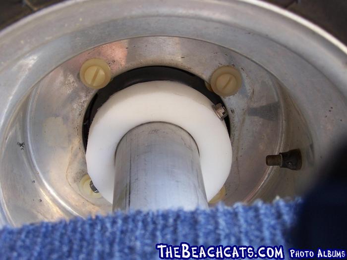

  • Nice one, I'm not clear how the white washers are staying in place. Is there a large cotter pin through the axle?
    I don't know anything about plumbing parts, does a 2 inch Schedule 80 socket flange have a 2.25 inch hole that becomes the wheel bearing in your design?
  • A lot of weight could be saved smooth tires could be found. Maybe put your ATV treaded tires on a lathe and smooth them down. icon_biggrin Wonder how much all that tread weighs.

    I like the idea. I some some concernes about the pipe flange not offering a ton of support for holding the wheel strait up and down. How much play is in the system now? Do you have a way to lubricate the flange?
  • QuoteNice one, I'm not clear how the white washers are staying in place. Is there a large cotter pin through the axle?
    Hope this picture will clarify how the the wheel/flange/axle is put together. The axle is 2.25 OD but the hole in the flange is roughly 2- 3/8" so it allows the flange to rotate freely. The plastic washers are held in place by two stainless screws. You can see the flange holes are larger but the rounded nuts will center flange to wheel.http://www.thebeachcats.com/gallery2/main.php?g2_view=core.DownloadItem&g2_itemId=103187&g2_serialNumber=3

    Pete, I thought of that too, but taking a hacksaw to a pair of $400.00+ beach wheels would make my feet sweat! This set will stay permanantly with the Wave, so if I'm off somewhere with the 5.7 one of the kids can still use it and have a set of wheels. Besides I was just curious to see if I could do it.
    Quotesome concernes about the pipe flange not offering a ton of support for holding the wheel strait up and down. How much play is in the system now? Do you have a way to lubricate the flange?
    I think, after using it that there would be more concern with the plastic bolts shearing off than the flange breaking. If that happens I would just rotate the flange a quarter turn, drill new holes and use stainless bolts. There is some play, but not much more "wobble" than the storebought. Getting the plastic washers tight to the flange helps. When there is weight on, the wheels stand straight.http://www.thebeachcats.com/gallery2/main.php?g2_view=core.DownloadItem&g2_itemId=103190&g2_serialNumber=3 I just let water be the lubricant because I felt greasing it would attract sand and wear it faster.

    OK, cool. I like that you did so much with off the shelf parts, even the white plastic chopping block washers could be made by anyone with a jig saw.
    But what would the total price really be assuming you need to buy everything at retail prices.
    I've never found the smooth 21x12x8 tires used on the real Cat Trax for sale anywhere. Closest I've found were these 22x11x8 "turf saver" with light tread available from Walmart for $68.
    http://www.walmart.com/ip…and-Garden-Tire/23597334
    What about the aluminum rim? And the aluminum axel?
    Can anyone come up with a complete parts recipe with links to purchase all the items needed?
