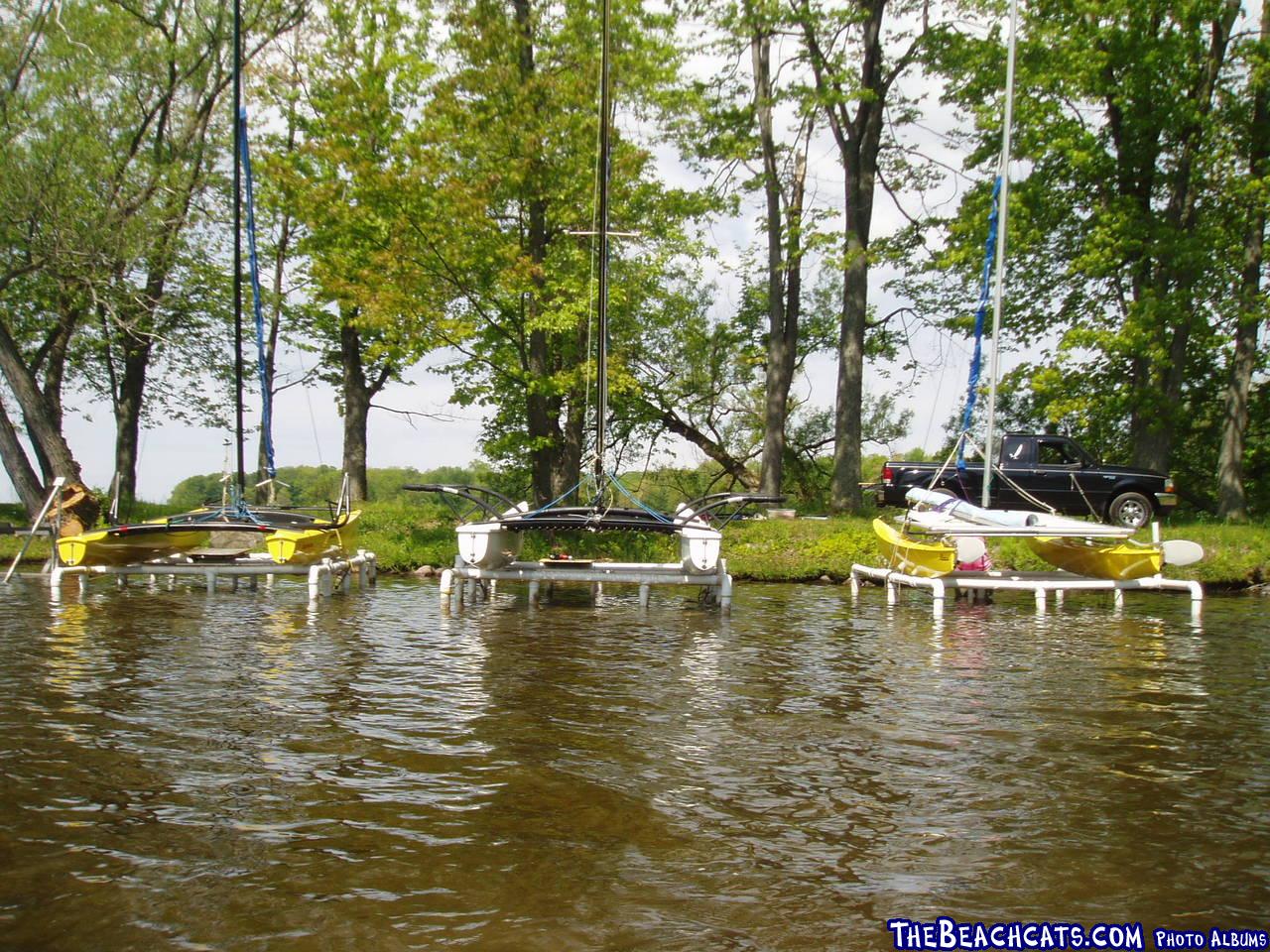

    Could you build yourself something like this instead of using a mooring?
    http://www.thebeachcats.com/gallery2/main.php?g2_view=core.DownloadItem&g2_itemId=46884&g2_serialNumber=4
