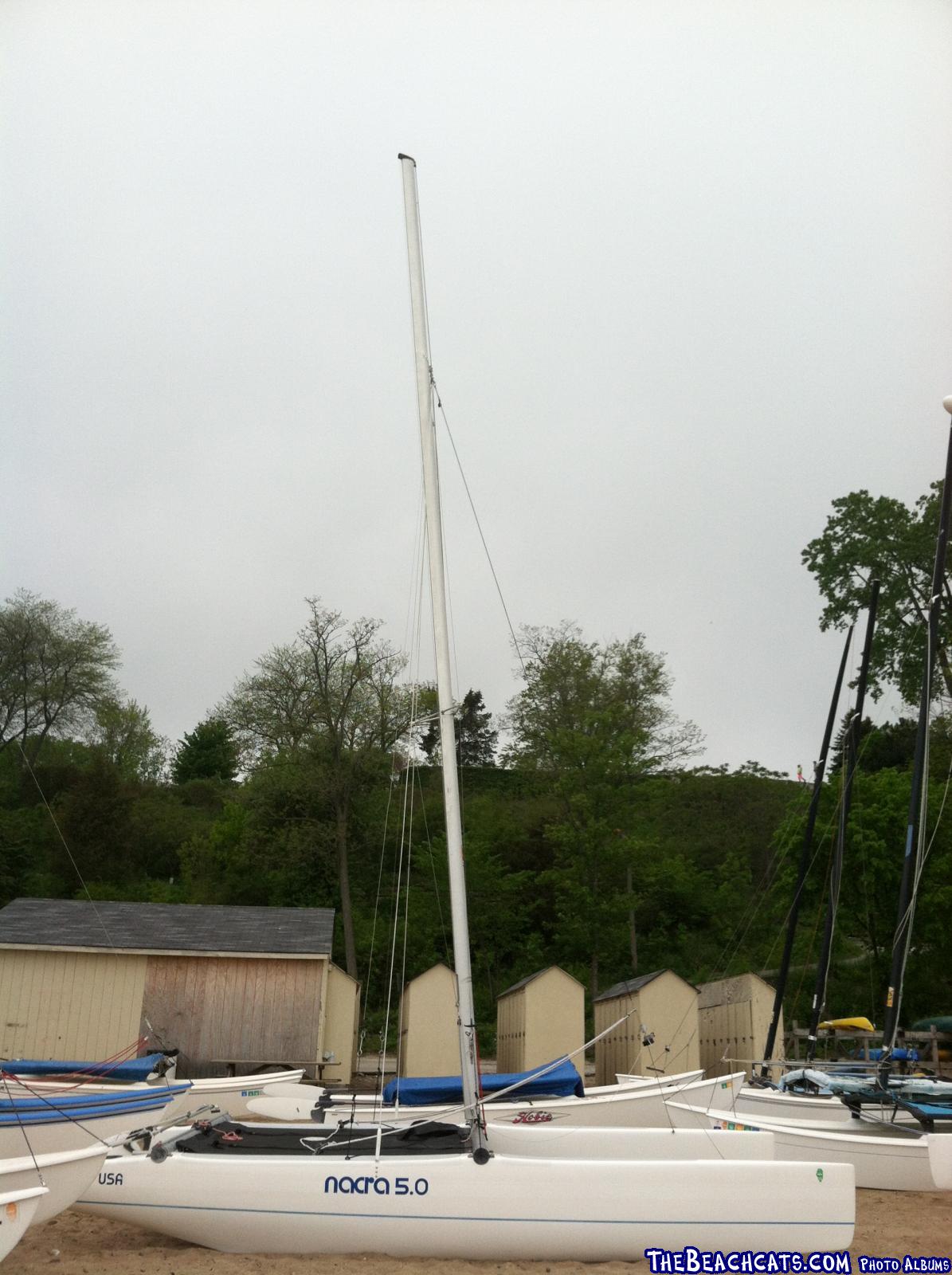

  • not a very scientific mode of determining mast rake, but i noticed the same.
    http://i16.photobucket.com/albums/b5/matt9229/IMG_0556_zpsebbec080.jpg

  • matt922not a very scientific mode of determining mast rake, but i noticed the same.
    The mast rake on my boat is very close to yours. DO you also have adjusting screws flush with the outside of castings?
