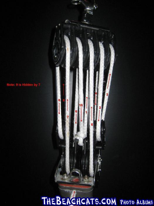

  • Hi, I just bought a 10:1, http://www.murrays.com/archive/20-21.pdf , like the one in the PDF. Unfortunatley, I did not get the instructions to assemble with it. Could anyone give me a lead as to how to set it up properly. Thx!

  • Send me a PM with your e-mail address and I can send you a PDF with a simple drawing that you can connect the numbers and feed your sheet through the blocks per the numbers.

  • http://www.thebeachcats.com/gallery2/main.php?g2_view=core.DownloadItem&g2_itemId=102222&g2_serialNumber=4
  • Thank you for the help guys icon_smile
