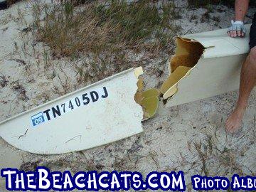

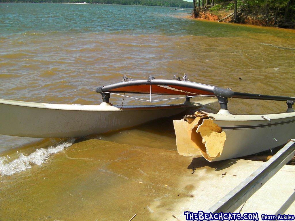

  • downsjnalso, one of the hulls is soft in the middle under the tramp. anybody ever had one fail catastrophically?
    http://www.thebeachcats.com/gallery2/main.php?g2_view=core.DownloadItem&g2_itemId=119799&g2_serialNumber=3
    http://www.thebeachcats.com/gallery2/main.php?g2_view=core.DownloadItem&g2_itemId=119800&g2_serialNumber=3
    http://www.thebeachcats.com/gallery2/main.php?g2_view=core.DownloadItem&g2_itemId=119801&g2_serialNumber=3
    It does happen and can be dangerous.

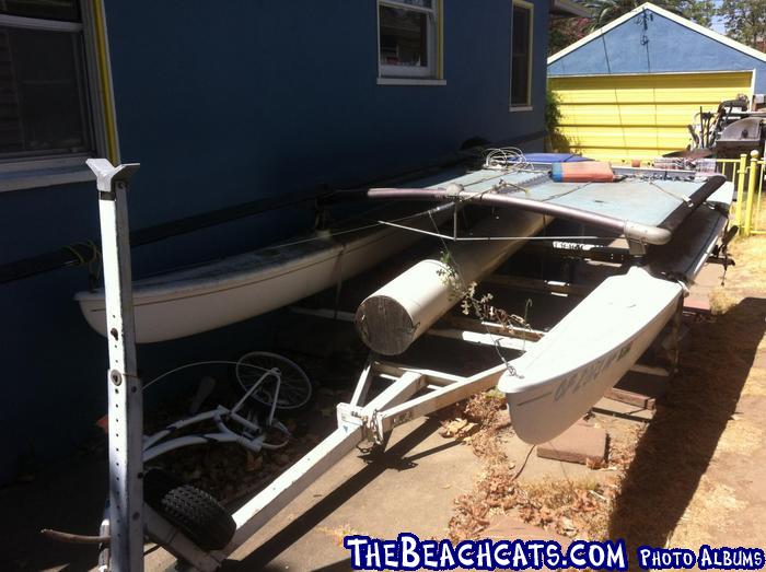

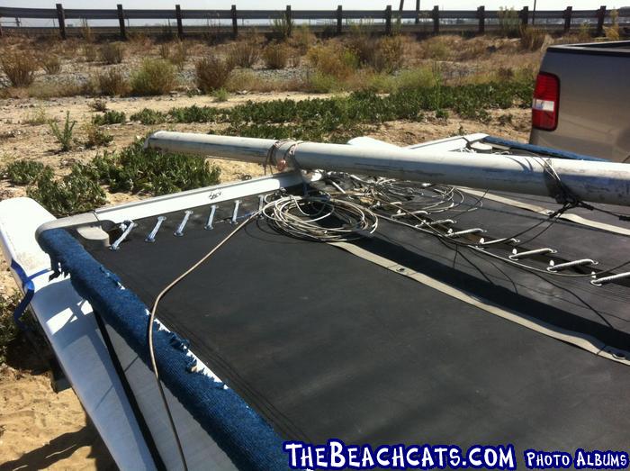

    http://www.thebeachcats.com/gallery2/main.php?g2_view=core.DownloadItem&g2_itemId=119806&g2_serialNumber=4
    can you see that on the back cross bar there is a simple metal cleat in the middle of the starboard side, i figured that was for the traveler.
    there was also the swiveling cleat in the middle for the normal H16 but no eyelet under the rear crossbar for the end of the main traveler sheet. how is a set up like this supposed to be rigged? what were those little cleats for?
    there was also a single swivel cleat (like the one in the rear for the main traveler sheet) on the front cross bar. What's that one for? it was only on one side and not for use with the jib sheet, the jib blocks had cleats on them) here's another crummy photo of the hardware i'm describing...it was on my old 14 too.http://www.thebeachcats.com/gallery2/main.php?g2_view=core.DownloadItem&g2_itemId=119851&g2_serialNumber=4 you can see it on the port side of the mast step ...if you squint
    anyway i had it out two days, all day, in and out of 5 foot surf, with the main traveler rigged two different ways, none with any mechanical advantage for me.
