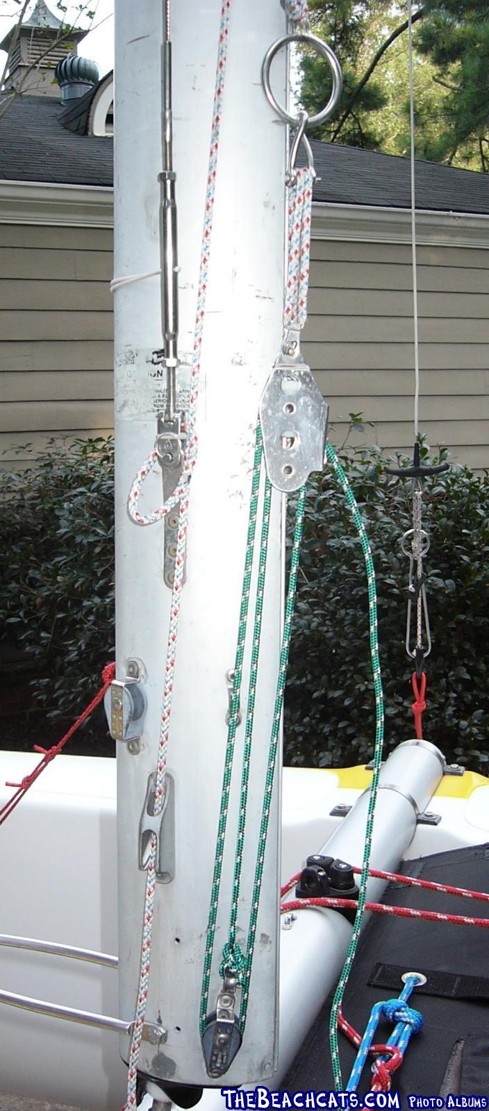

    I cribbed this photo from Wolfmans N5.2, showing how to rig the downhaul.You won't have the boom, or wishbone, & the eyestrap on the mast should be below the cheekblock(he is using the one originally for the jib).
    Feed the foot of the sail into the groove, place the "S" hook into the sail clew, pull the line to tension, yank the bitter end into the jam cleat. Rig it with "good" line, something stiff that will really stick in the cleat, & resist wear. Once it starts to wear, reverse it to get double the life. Better yet, get it 8" longer than what you need. You can then move the knot that dead ends it on the eye strap. That will move the point where wears in the jam, you get years of use out of 1 line.
    Note how the "S" on the hook must be turned 90*to the body of the fiddle block, easy to do in a vice & a crescent wrench. If you don't do this, the block wears against the sail.
    Make damn sure the little swaged ball on the main halyard is fully in the "fork" up near the masthead. The 5.0 is trickier than the 5.7 as the fork is closer to the top. I always bring the halyard towards the rear & give it a good yank, to get the line/ball fully into the fork. If you don't, it will pop out, & the downhaul tension will jerk the sail down, quite possibly tearing the sail right at the groove where you feed it into the track. This is a major PITA if solo when it happens as you have to dig out the halyard & rehoist the sail, while bobbing around at the worst possible time.
    http://www.thebeachcats.com/gallery2/main.php?g2_view=core.DownloadItem&g2_itemId=74395&g2_serialNumber=3

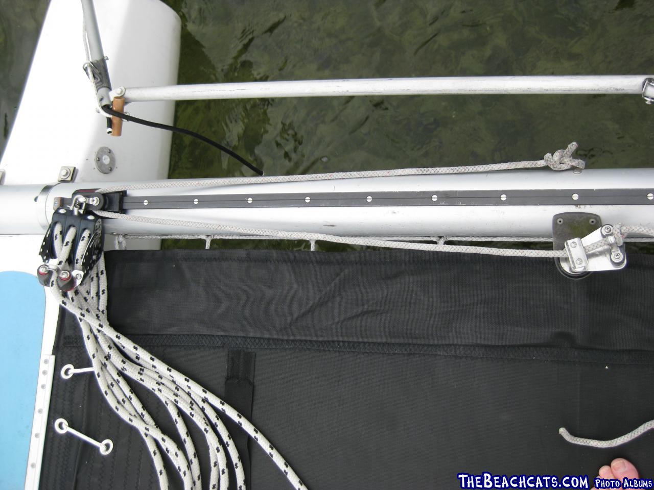

  • Look closely at where the tie bar meets the tiller arm. See the bottom the "U" fitting that holds them together? That is where you want to wrap SS lockwire to prevent that fitting from turning on the bolt.If it does it will lock up your rudders.
    Murrays sells a double "U", for about $55, supposedly to prevent this problem. They can still lock up, just use 50 cents worth of wire, & save the $55 for beer, or a new FX stik.
    Also, note the stopper knot in the traveller line. Put it in so the car cannot quite reach the end of the track. At some point you will gybe & not finesse the car. If it slams into the end of the track, it will shear the stop, go off the track, & $20+ worth of bearings will go into he drink. Cick on photo to blow up to full size.
    http://www.thebeachcats.com/gallery2/main.php?g2_view=core.DownloadItem&g2_itemId=74464&g2_serialNumber=3
  • QuoteEd, I would be interested seeing that in the pictues.
    Here is a better shot, of how it should be rigged. This is not my boat, I think it's an old shot from Philip(MUMMP), but this is how I do it. Ignore the stuff on top of the block, just rig as per his green line. I think he was set up with another piece of line dead ended on the other side of the mast, that ran through the sail grommet. If you hook the "S" hook onto that line it doubles your purchase, but you don't want to do that on your 5.0. Those sails were not designed to suffer those kinds of downhauls. If you have to attach a cheek block or eye strap, plan it out, you will want the fittings as low on the mast as you can get them,(you can't go right to the bottom of the mast as the base extends about an inch up into the extrusion) as the stock 5.0 sail grommet sits quite low. Note how he has fitted the eye strap to the top hole of the cheek block.
    I never remove the system. When done sailing just remove the "S" hook & clip it to the bottom of the diamond wire, then snug up. See those 2 holes in the mast? If you have anything like that seal them! If you ever turtle the boat, you will severely regret leaving something like that open.
    http://www.thebeachcats.com/gallery2/main.php?g2_view=core.DownloadItem&g2_itemId=74296&g2_serialNumber=3
    That was an old set up. Ed, you are correct. The white line with blue and red tracers indeed goes through the cringle and dead ends on the other side of mast. There are alot of different blocks you can set up to do this. In the picture I used a Fico fiddle block with jam cleat. Simple, minimum amount of hardware and effective.
    Here is the picture with the description.
    http://www.thebeachcats.c…293&g2_imageViewsIndex=1
    I later upgraded to a stiffer mast section to match a PE15 high aspect ratio main sail, which required this for the downhaul.
    http://www.thebeachcats.c…290&g2_imageViewsIndex=1
