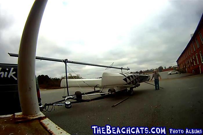

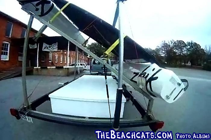

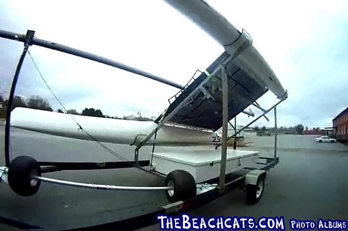

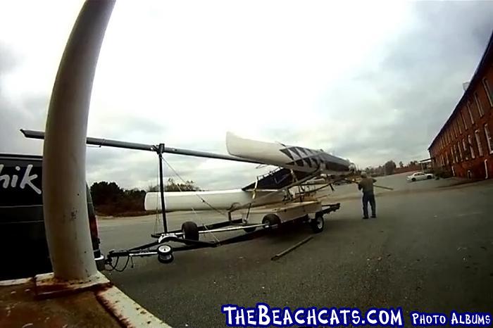

  • The Tilly Trailer mentioned by Jay is by far the coolest in operation, but this one built by Mike Krantz for his Carbon 20 (10.5 feet wide) is the simplest one I've seen.
    One man operation, no motors, cables, or winches, just two hydraulic struts.
    video and bigger pictures in the Tech gallery.
    http://www.thebeachcats.c…ctures/?g2_itemId=101149
    http://www.thebeachcats.com/gallery2/main.php?g2_view=core.DownloadItem&g2_itemId=101152&g2_serialNumber=4 http://www.thebeachcats.com/gallery2/main.php?g2_view=core.DownloadItem&g2_itemId=101156&g2_serialNumber=4 http://www.thebeachcats.com/gallery2/main.php?g2_view=core.DownloadItem&g2_itemId=101159&g2_serialNumber=4 http://www.thebeachcats.com/gallery2/main.php?g2_view=core.DownloadItem&g2_itemId=101165&g2_serialNumber=4
