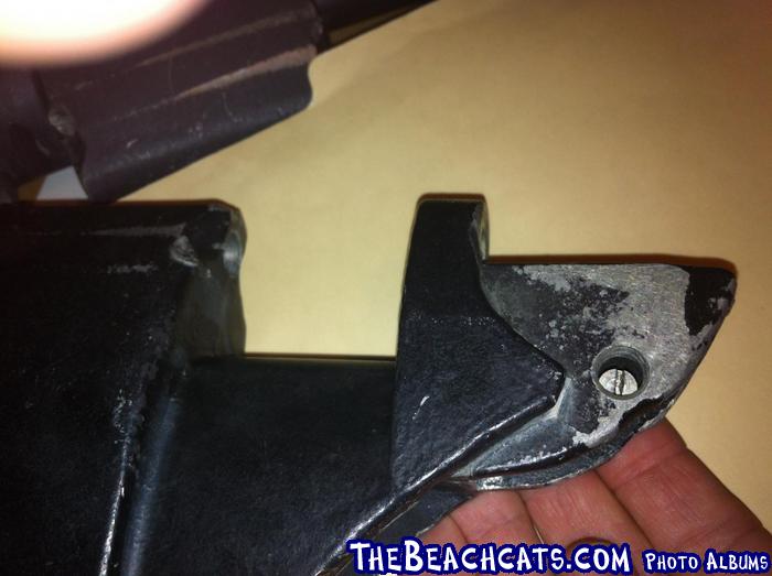

  • Here is a picture of the sister screw sitting flush to the lower casting. I am holding the screw up from below.

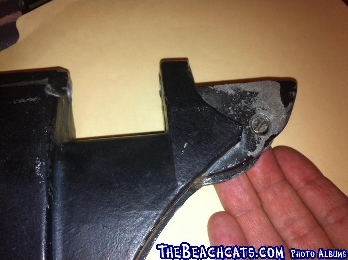

    Here is the same picture with the head of the screw slipped through the casting. The hole should have a small enough diameter to not allow the screw head to drop through.

  • Ted, this is where a sailor gets innovative, go to your local Ace Hardware store, they have a hardware and fittings section, take both the casting and the sister screw with you, look for a SS screw that matches your sister screw but has a bigger "head". Someone has definitely drilled out the casting, if no luck on a larger screw head, maybe some kind of bushing to fit that hole but will not affect the movement of the cam? Worse case scenario you have to drill both casting and cam, and use your own oversized SS hardware to hold cam in place.
