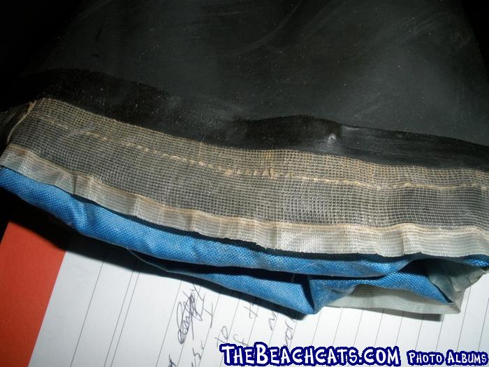

This looks like it is on the inside of the sleeve. You should glue the new seals to the outside of the suit. Prep it with sanding and Cotol first, then add the Cotol to the Aquaseal to speed up the curing.

Yep. Remove all the stitching and all but that 1/2" ring on the outside. When you remove the stiching, will all the old seal come off?
If not, now sand the ring of original seal to roughen it up, and prep it with Cotol, Let that dry and then glue the new seal over the old one.

Here we have a drysuit with sewn seals- clearly not intended to be replaceable.
What Pknapp66 has to do is remove everything he can including the stitches, use a firm plug on the inside and glue the new seal to the outside. Acetone and alcohol are just cleaners, where as Cotol is a catalyst for Aguaseal, and will encourage a better bond around and through those hundreds of holes put in the sleeve from sewing.

Just to clarify. After I pull the stitches i totally remove the rubber seal and glue the replacement to the fabric?
Aquaseal will adhere to the fabric? If so the job becomes much easier.

Aquaseal is VERY sticky stuff. Without seeing exactly what is going to be glued, I can't be sure. I would try a small,(1 sq cm) spot & see how it does, before I went the whole enchilada.
If you need the Aquaseal to penetrate fabric, & seep into needle holes, be very careful with mixing cotol. Adding it thickens the mixture within the time you stir it. You want it to seep into all the pores, therefore you want very little cotol.
An option might be to vigorously rub some plane AQaseal into the fabric, sort of saturating it like fibreglass matt/resin. That will seal the fabric & holes. Let that set up til at least tacky, then as stage 2 bond your seals.
