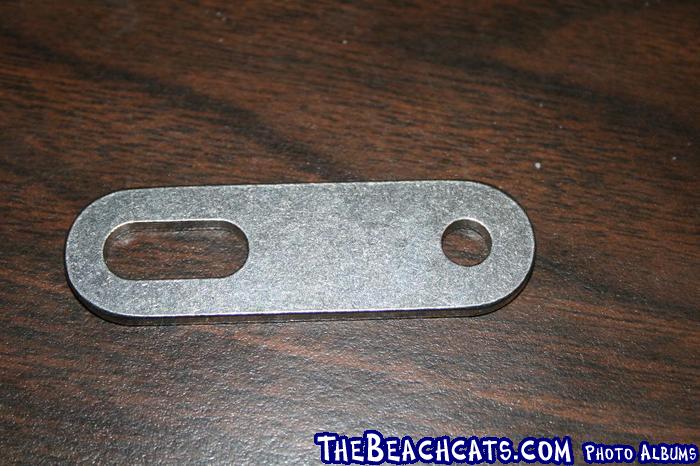

    At the top end, you cannot directly connect the swivel to the bow shackle that also holds the shrouds. The simplest is a short tang such as this http://www.thebeachcats.com/gallery2/main.php?g2_view=core.DownloadItem&g2_itemId=75023&g2_serialNumber=5
    Note that one hole is larger, to allow the shackle end to pass through.

  • Quote I war one of those tangs for my swivel.
    The photo of the tang was sent to me by Philip,(MUMMP) I believe. I don't actually use one. I didn't have access to one when I first rigged the system. What you see is a scrap of SS flat bar, with two holes drilled, courtesy of a cobalt 1/4" bit I had.
    Ditto for the small tang below the drum.

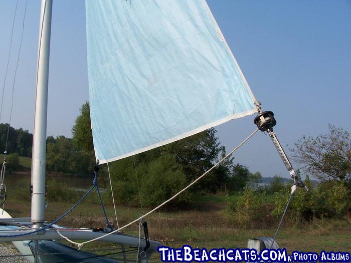

  • one of the pics you have is of my original furler setup on my H16, I was experimenting then.....
    http://www.thebeachcats.com/gallery2/main.php?g2_view=core.DownloadItem&g2_itemId=88279&g2_serialNumber=4
    .....and you were quite correct in your assumption, I did not have a shackle large enough to attach the furling drum to the bridle wires, so I attached the stay adjuster 1st then the drum. I did not have to adjust mast rake so this worked for me at that time, an additional bonus was that the stay adjuster did not interfere with the jib tack, causing chafing.
    I have now adopted this same furling rig to my G-Cat 5.0.......
    pigtail + swivel + forestay + stay adjuster + furling drum = length of G-Cat original forestay,
    .......purely co-incidental, but it worked, except this time I had a shackle large enough to attach the furling drum to the bridal wires. But now the 10-hole stay adjuster chafes on the jib tack when the jib is furled as I have the jib forestay secured in the 3rd hole down. To prevent this, I use electrical tape around the top part of the stay-adjuster where it rubs on the jib tack. JMTCW

  • Edchris177
    Ditto for the small tang below the drum.Edited by Edchris177 on Jul 13, 2012 - 11:22 PM.
    Part is called a Mast Tang Plate I20 Spin
    Part #56-9649
    Murrays has it, or check with a Nacra dealer.
