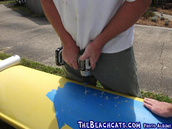

  • http://www.thebeachcats.com/gallery2/main.php?g2_view=core.DownloadItem&g2_itemId=72664&g2
    big soft spots on the foredecks are common for these old beauties...simple injection repairs and your good as new, don't let people sit/stand on decks-even though they are inviting you to do so! no biggie, you can use standard polyester resin for the fix(bondo/3m brand resin @ lowes). i would shop for a descent set of used sails and go for it! don't sweat the paint job just yet...sail it a bit and see what else it may need. enjoy!
