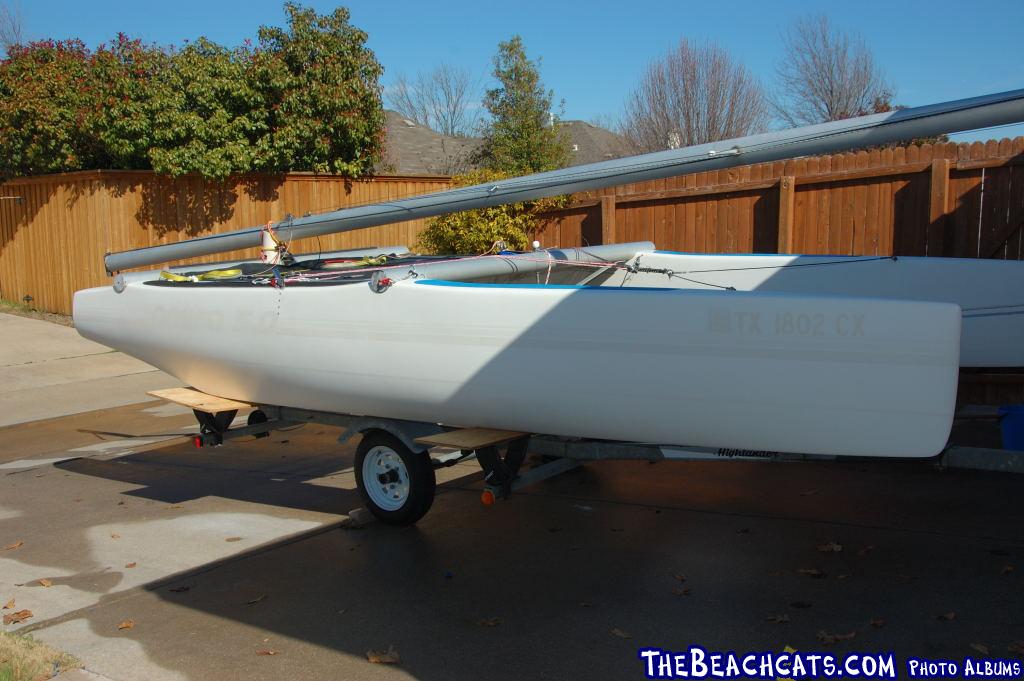

    Here is the boat after removing all of the old, cracked vinyl graphics and after a good cleaning with Bar Keepers Friend and PoliPrep.

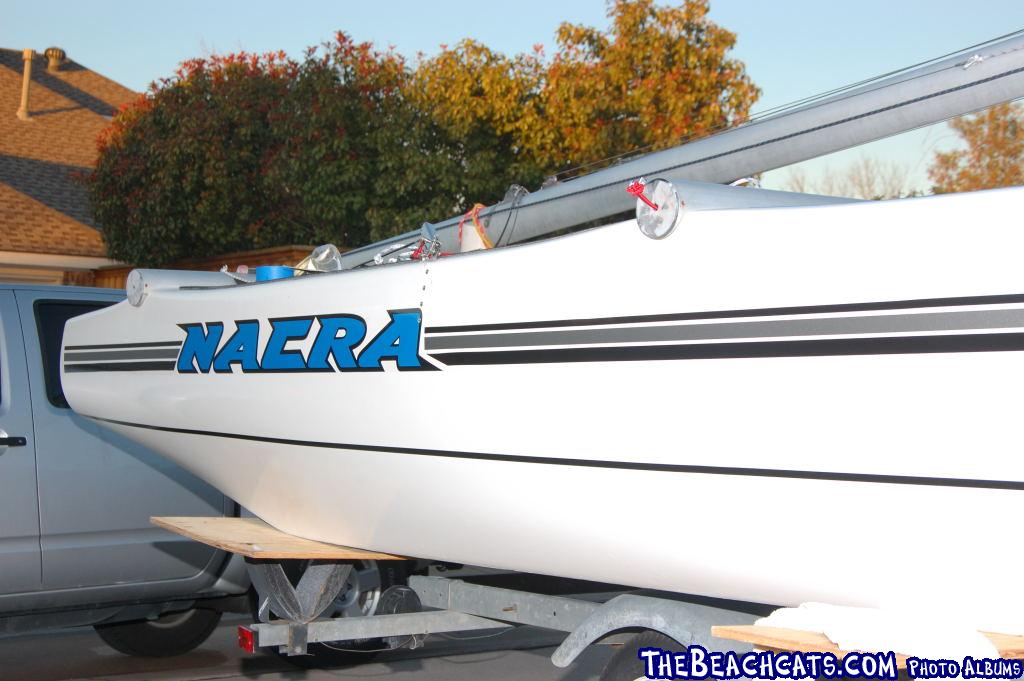

    And now, with the new decals installed (thanks Bacho for emailing the vectored image files) and new pinstriping. Also, the picture is taken before applying PoliGlow.
