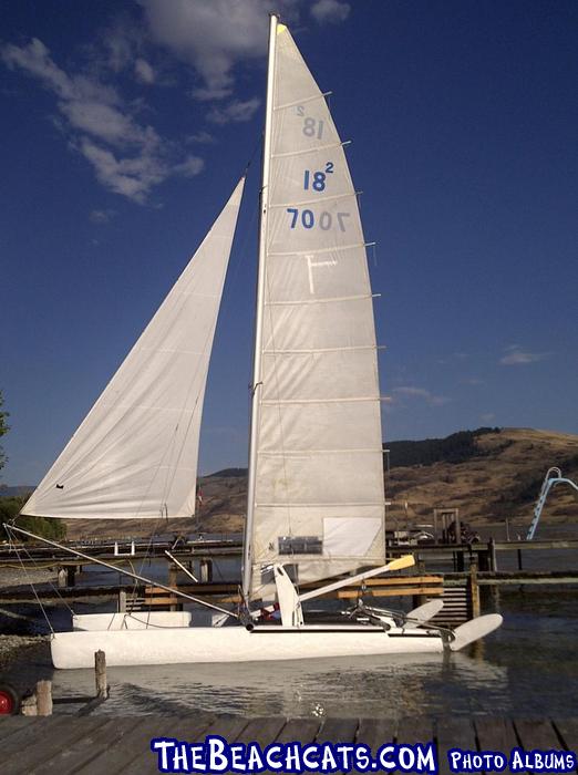

  • Hello I picked up a NACRA 18 Sq a few years ago.
    What can I do to make her go faster?
    Or should just get a newer bigger cat as I am 6' 2" 290 lbs, and the winds are pretty light around here.

  • Are the problems only downwind, or upwind as well? You are already sailing the largest one-up beachcat out there! try adding a really flat cut assy spi or screacher. And a new squaretop main maybe.

  • I tried adding a jib I picked up but it turned out badly when it unfurled in its shore rack. Nuff said.
    http://www.flickr.com/photos/31840888@N08/6202008461/in/photostream
    At the end of this year I found an Allum scaffolding tube and added a hooter(Heavy I know but the price was right untill I can find a cheap windsurfer mast). It seemed ok but I only got to try it once and I don't think I will be able to use in higher winds. I also added a 2:1 purchase to furl closed better.
    http://www.flickr.com/photos/31840888@N08/6202521180/in/photostream

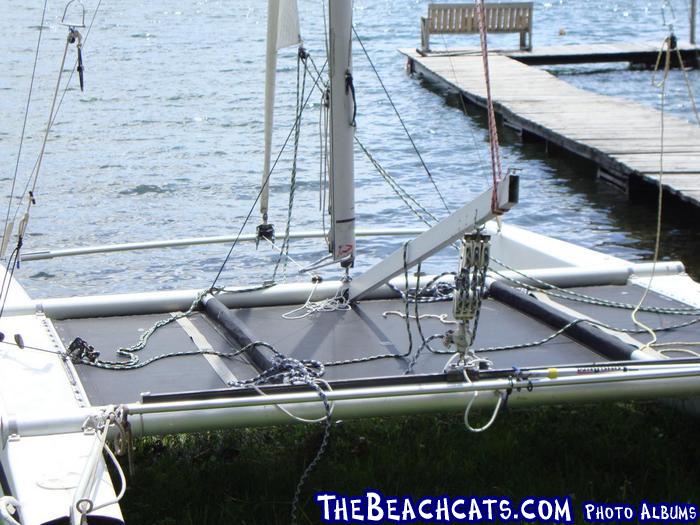

    I was also thinking about adding an outhaul, but I don't want to lower the boom any lower in doing so.
    I was thinking about putting some sort off U slide on top of the boom with two bolts thru the boom which would slide along a cut out groove? Using internal sheaves for the purchase?

    I just put the jib I had, on as a screecher/hooter and while it did seem to give better pull in the one try with light wind. I'm not sure how much wind I will be able to use it in being such a hap hazard set up?

  • If you're sailing an original NACRA Square, it'll have a fairly bendy mast, and putting a headsail on it is a very bad idea. You will break that mast.
    Glaser is the man for building mains for Squares.
    You should have an outhaul on your boom already. Bit of track with a car on it. If you don't, then do like the more modern cats and just make a loop of HM line around the boom with bungee return and line-to-cleat out. No need to add weight and complexity. Actually I think I've got an extra boom somewhere but I really wanted to sell all my parts along with my Square.
    The usual MO for stock NACRA Squares is to add another foot to the mast height (from 30' to 31' mast) at the top. I found a NACRA 5.5uni mast and did that to it, so now mine is a prebend mast. That said, I have a custom Ullman main for my Square.
    There isn't a Outhaul. Just a bracket to pin the clew plate in one of two positions.

  • Tightening the diamonds should help, but then the main probably isn't cut for prebend. Swept-back spreaders are another typical upgrade, but then, you'll still need another main cut for the prebent mast. Frankly, your best investment would be in a new main and a decent boom from the sound of it.
    HM stands for "high modulus" http://en.wikipedia.org/wiki/Ultra-high-molecular-weight_polyethylene ,and yes, Kevlar is one example
    Is your main loose-footed? I've never seen a Sq w/o an outhaul.
    Here's a pic of something like I had in mind.
    http://www.glen-l.com/free-book/rig3-18.jpg
    the difference for you is that you'd make a loop of HM line thru the clew round the boom, provided it's a loose-footed main. This is instead of a car and track and what will hold the clew to the boom. Also, from the clew to some point forward on the boom, you'd attach a bungee so the clew will come in automatically, as it were. If your boom is rectangular, as is mine and all the other stock Sq I've seen, the loop round may not run as smoothly as you might like and you might have to rig something different. But it's easy/cheap/simple to see if that works for you.
    The Formula 18 cats have something similar although their booms are simple carbon tubes. You can find something like an old windsurfing mast etc to use to fabricate same.
  • QuoteIs your main loose-footed? I've never seen a Sq w/o an outhaul.
    Yes she is loose footed. Here is a closer pic of the boom area.
    http://www.flickr.com/photos/31840888@N08/6202014617/in/photostream
    That HM line outhaul with a bungee return and cleat tension absolutely sounds like my best bet.

    and I would say, now that I'm looking at the little pic I put up, I'd use a small camcleat and fairlead rather than a jammer.

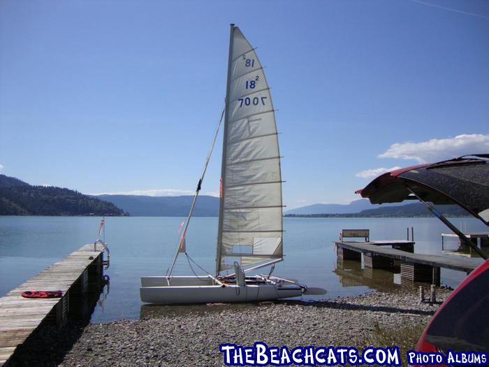

  • I've removed the jib configuration and am now trying for a hooter as the pics will show.
    Sorry about my feeble attempts at posting a pic I was cutting from the address line not the rt click pic.
    Old Jib set up wasn't working for me.
    http://www.thebeachcats.com/gallery2/main.php?g2_view=core.DownloadItem&g2_itemId=82599&g2_serialNumber=4
    Hooter set up.
    http://www.thebeachcats.com/gallery2/main.php?g2_view=core.DownloadItem&g2_itemId=82615&g2_serialNumber=4
    Pic showing non outhaul and stock boom setup. Ignor the cross beam jib up front.
    http://www.thebeachcats.com/gallery2/main.php?g2_view=core.DownloadItem&g2_itemId=82594&g2_serialNumber=4

  • QuoteWhen in your shore rack remove the jib sheet and tie a line or bungee or something through the clew and around the rolled up jib to keep it under wraps. That way you don't have count on just the furler line staying cleated to hold it all in place.
    I'm actually going to use a 1:2 purchase for this attempt at a Hooter. This makes the hooter lines furl around the sail at least three times.
    So hopefully I won't get any unplanned unfurling. No I don't have a snorkel, yet.
