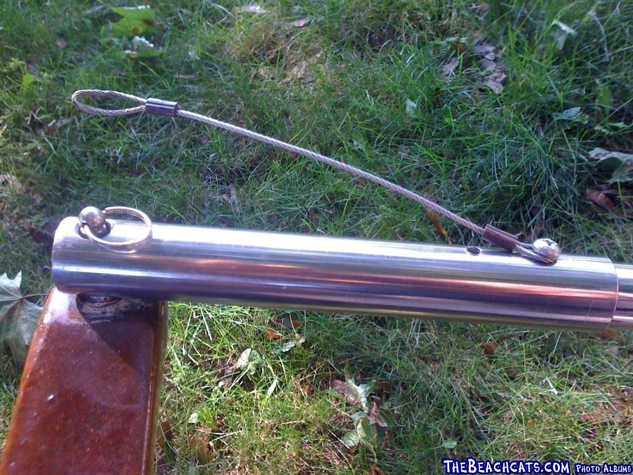

  • Here's the picture link in members albums....
    http://www.thebeachcats.c…ictures/?g2_itemId=80248
    it's in my album, first pic. I couldn't figure how to post a pic here from my desktop.

  • Wow, that gear looks like new! I now understand what your original post meant. It will be fairly easy to drill the tubing, just be sure to center punch a mark, so the bit doesn't wander when starting. Measure the center pont between the ends of the connector bar, orientate the hole on the circumference so your stik lines up in the best position.
