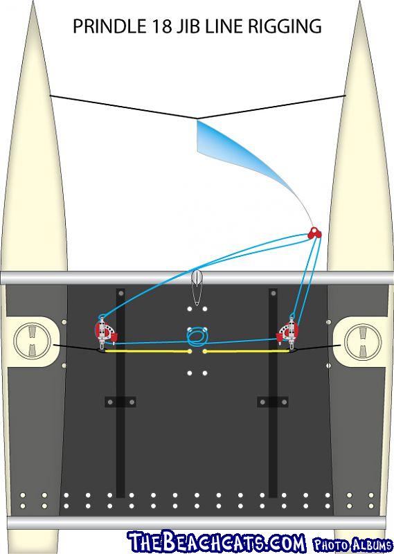

  • Does the P16 rig just like the P18?
    If so take a look at these pics
    http://www.thebeachcats.c…ictures/?g2_itemId=76587
    If not, someone please make an album like this for the Prindle 16.
    http://www.thebeachcats.com/gallery2/main.php?g2_view=core.DownloadItem&g2_itemId=76604&g2_serialNumber=3

  • DamonLinkousDoes the P16 rig just like the P18?
    I'm pretty sure they are the same but some P16's may have a barberhauler setup with some blocks on the font beam that might make it more confusing.

  • Right with the barberhauler you have the jib setup like the pic above but you have some additional parts.
    http://www.murrays.com/mm5/graphics/00000001/01-5155.jpg
    http://www.murrays.com/mm…y_Code=C-J&Store_Code=MS
    The blocks on the upper left and right of the picture go in your jib sheets on each side between your blocks on your tramp and your jib clew. The other blocks go on the outside of your beams. The line runs from the first block out to the beam block then back along the beam the cleats in the picture. Same for both sides. I am not sure why there are 2 lines I would think it better to run one continuous line like you jib sheet where it comes out the cleat on one side then back on the cleat on the other mirroring the first side on the other.
    The purpose is fine tuning of the jib. The block between you jib blocks and the clew and be pulled on to pull the jib farther towards the beam.
    For now I recommend you ignore the barberhauler and just sail it with the regular jib setup. When you think you have a good handle on sailing the boat without it then you can look at adding it. To me it just seems to make things overly complicated. I think it can help a bit sailing downwind but it is not needed to sail the boat.
    If the PO was running his jib through the barberhauler setup he probably never had the jib tuned where it needed to be.
