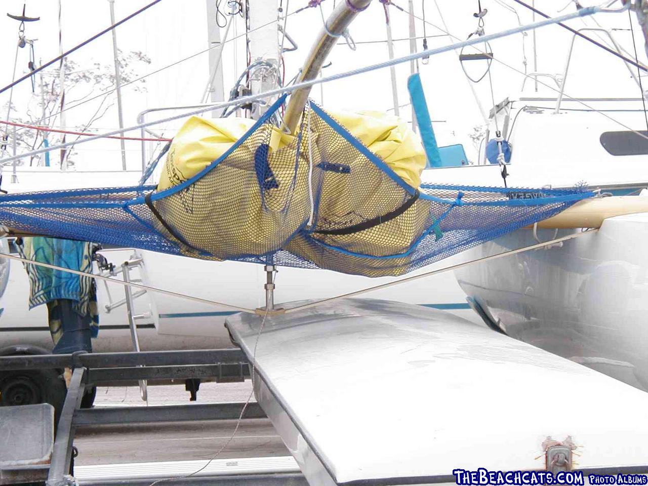

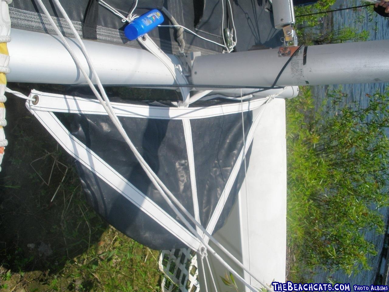

    Here's a couple of others that have been done.
    http://www.thebeachcats.c…ictures/?g2_itemId=81260
    http://www.thebeachcats.c…ictures/?g2_itemId=19005
    http://www.thebeachcats.com/gallery2/main.php?g2_view=core.DownloadItem&g2_itemId=81269&g2_serialNumber=3
    http://www.thebeachcats.com/gallery2/main.php?g2_view=core.DownloadItem&g2_itemId=29832&g2_serialNumber=4
