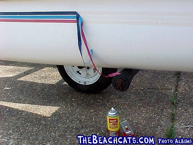

  • I want to remove the stock sticker graphics from my hobie. Is it okay to use a product like "goof-off" or "goo be gone" on the hulls to remove glue residue?

  • Check this out.
    http://www.thebeachcats.c…ms/viewtopic/topic/11830
  • And this.
    http://www.thebeachcats.c…ictures/?g2_itemId=11249
    http://www.thebeachcats.com/gallery2/main.php?g2_view=core.DownloadItem&g2_itemId=27651&g2_serialNumber=4
  • Thanks for the replies. So, one post says don't use goof off, it'll remove the gelcoat while another post shows someone using goof-off to remove stripes. Is there a consensus?
    2011 Hobie 16SE
    Atlanta, GA
  • Acetone. It'll remove the goo and wont screw up your gelcoat. Just wear gloves while using it. No idea about goof off, I wouldn't risk it.

  • motivatedThanks for the replies. So, one post says don't use goof off, it'll remove the gelcoat while another post shows someone using goof-off to remove stripes. Is there a consensus?
    There are a lot of different products in the Goof-Off line, all the ones I've seen list to be safe on Fiberglass, but read the labels.
    Wear gloves and work outdoors.
  • I used a heat gun... carefully. This was with the blessing of my autobody guy, Edso @ Mill City Auto, Westford Mass. Worked excellent, leaving no residual residue. Lastly I buffed out the hulls using compound and an orbital buffer. It came out like new. Edso said that it was OK to go agressive with the compound. The clear coat on your car is only two or three coats thick; begging you to be gentle and carefull with the buffer. The gel coat on the boat is the thickness of about twenty or so car coats. Have at it.
