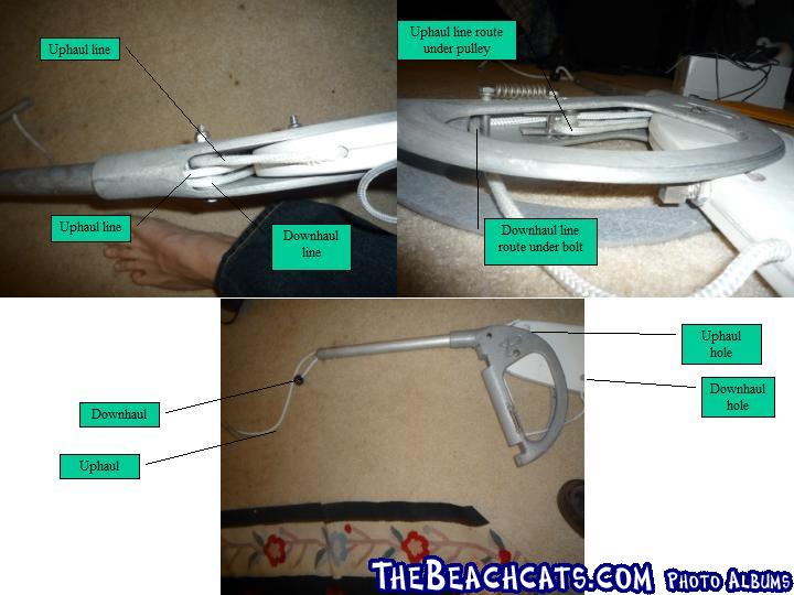

  • check this post: http://www.thebeachcats.c…ictures/?g2_itemId=72614
    The photos helped me get mine rigged properly. The rudders are impossible to pull up if you don't use the pulleys properly.
    http://www.thebeachcats.com/gallery2/main.php?g2_view=core.DownloadItem&g2_itemId=72617&g2_serialNumber=3

  • i used all pulleys on mine, they work great! put a ss washer between them.
    http://www.thebeachcats.com/gallery2/main.php?g2_view=core.DownloadItem&g2_itemId=76955&g2_
