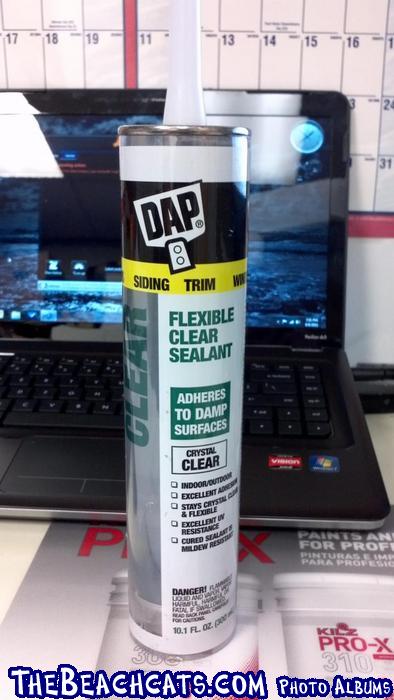

  • So I did some more research and came up with a possible solution for my application. It's a product made by DAP called Flexible Clear Sealant, (original, I know.) I work for Home Depot so I was able to talk to the Vendor about my application and he recommended this stuff hands down. It stays flexible, it's clear, U.V. resistant, mildew resistant, and it's a synthetic rubber base product that will not be a problem to paint around down the road. Best of all, he had a couple of samples, two scraps of wood to metal or plastic to demonstrate flexibility. He grabbed the wood to metal piece and pulled the two apart with what looked like a moderate amount of force. It's a little more expensive than silicone at $8 a tube but a bargain compared to 3M and others. I'm gonna give it a shot and see how it works out. Keep you posted on the results.

  • Here is a picture of the DAP product I was recommended.

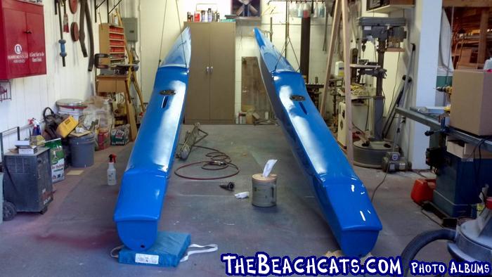

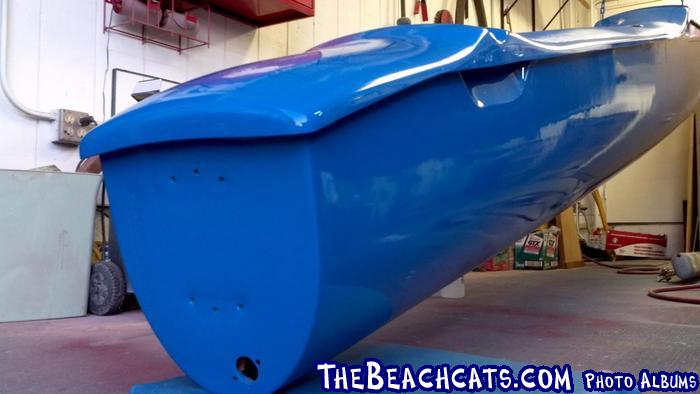

  • I was cleaning up the cross members last night getting them prepped for paint and looking over at my recently painted hulls, thinking to myself... http://www.thebeachcats.com/gallery2/main.php?g2_view=core.DownloadItem&g2_itemId=81428&g2_serialNumber=4http://www.thebeachcats.com/gallery2/main.php?g2_view=core.DownloadItem&g2_itemId=81439&g2_serialNumber=4 Do I really want to risk screwing up almost 40 hrs of work on an untested product that will, at best, work as good as a marine bedding compound that cost a little more. After a couple of beers and more sanding I decided to play it safe and stick with an application specific bedding compound. So forget my previous pos,t unless you would like to play guinea pig. icon_wink

    I actually played guinea pig for that product by chance. I needed to get the boat in the water and didn't have time to order anything marine specific. Short term results have been good. Boat is completely water tight. I taped off areas where I didn't want sealant prior to application. Cleanup requires solvent which would probably remove your paint but it was generally OK on my gelcoat. So far things look good, no discoloration etc.
