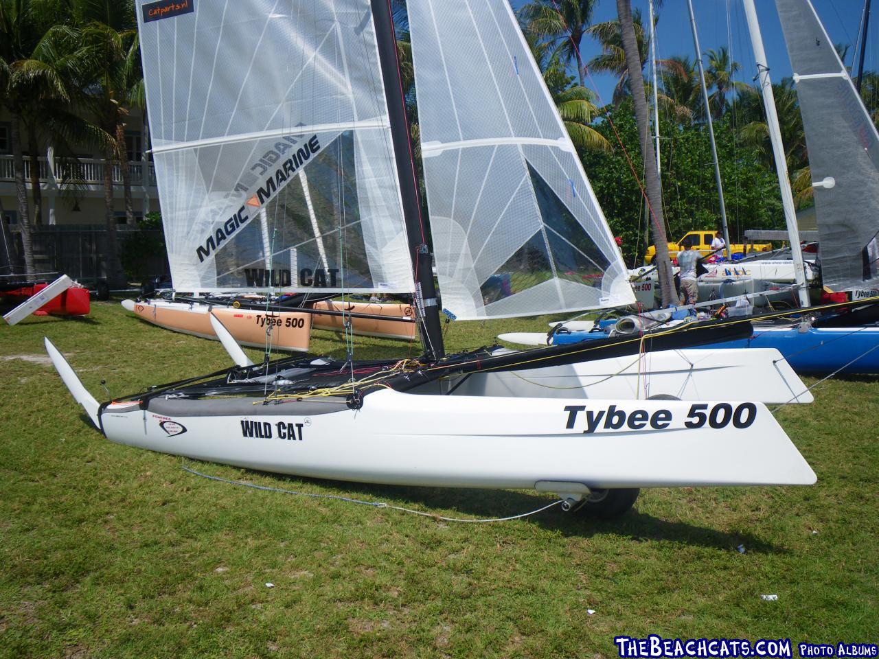

    That shot also show the molded in "gil" in the hulls, the brand new Hobie Wildcat has something very similar.
    http://www.thebeachcats.com/gallery2/main.php?g2_view=core.DownloadItem&g2_itemId=73342
