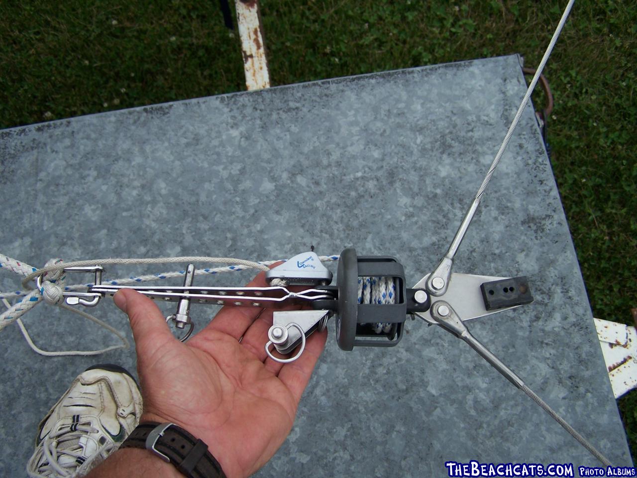

  • So I almost have everything to finish up the Prindle 18 with Hobie 18 Furler setup. I still need to actually shorten the extra forestay I have to become the furler forestay. I plan to keep my original setup just in case I need rig without it for some reason.
    I have a little snag with the halyard. I am used to hook an ring setup for tensioning the downhaul on the jib but I don't thin that is going to work anymore because I will need tie the foot of the jib into the furler for it to work. I had planned on doing that with a shackle the pins through the hobie furler. If I cannot use a ring at the top then I will need to tension by pulling the sail up instead of down since the foot will be captive instead of the head. I have seen pictures here an there but can nvr find them easily when i want to. I did try to search through some back posts here but was not finding what i was looking for
    I would appreciate an pics available and descriptions or ideas.
    I did see this and wondered about the little attachment that ties the jib on one side an seems to have a cleat on the other. I looked online to try to find something like that i could buy but did not find it.
    http://www.thebeachcats.com/gallery2/main.php?g2_view=core.DownloadItem&g2_itemId=79929

  • The only problem is there is no block shackled to the swivel and no wire halyard. I am not using the Hobie wire Hlyard system. The only thing hobie is the furling drum. Up top I have 2 options , mount the swivel to the hound the the upper forestay which had a pigtail for the jib halyard with a ring to set the hook on the halyard. Then tighten at the bottom by having a line from the foot of the jib act a a downhaul. This is how the mian works and how the jib was before the furler.
    Option 2 is mount the upper forestay to the Hound then the swivel then the lower forestay. Ignore the pigtail and thrown a small block that is already part of the halyard on the ring and use the to raise. I will remove the hook and there will be nothing holding the jib up other than the tension of the halyard as it pulls up through the block then down to the bottom where I dvise the best way to cleat it off. In the the foot is secured via shackle to the Fuler.
    Option 1 may not work because the foot is not tied to he furler. It may turn fin with the hook in the ring but it makes me nervous.
    option 2 should work but I want to know what you guys do to secure the downhaul this way. Pics would helpful with descriptions. My halyard has sister clips to detach half at the bottom.
    I have no interest is converting to a hobie style wire halyard.
  • Dustin, upper forestay connects to mast hound, then swivel, then lower forestay. Ideally, the lower forstay is almost the same length as the luff of the jib with just the closed end thimbles sticking out top and bottom. Secure jib to forestay using a shackle through the jib eyelet and then through the thimble, top and bottom, this attaches jib to forestay so that when the furler turns, the sail rolls up around forestay, otherwise forestay would spin inside jib luff. I kept my P18 jib, ordered a lower forestay with my P18 jib luff measurements, took out the small batton on jib, secured jib to forestay as above and jib furls fine. I used my original upper forestay with ring, the old setup will allow me to pull a sock up over jib for protection if I ever leave the cat mast up.

  • ok so the idea is growing on me. The hobie furler has an adjuster that passes through the center of it so I don't think I will need the 10 hole. I will likely leave the turnbuckle on connected to this adjuster.
    I have a p19 forestay I can shorten to size. You said you kept your upper as is and shortened the lower to the luff of the jib? How much do you think you took off?
    My furler is a little different in that the drum is below the bridles. It is hard to explain unless you have seen the hobie furler. I will be connecting the same Prindle bridles to the hobie furler using shackles.
    I can see the usefulness of having the jib always attached I will just have to buckle down and make a cover for it.
    I am excited to get this going but nervous it's not gonna be right or have a problem with length or something. I will likely be shortening on my own (swager at west marine) or I have rigging guy in town tomorrow that might can help

  • You got it! just remember to measure by pulling, I took my forestay and jib out into the yard, drove a screwdriver through the the head grommet, pulled down on the tack, used another screwdriver through the tack grommet and then measured, so my jib was measured with downhaul already on it. When I ordered my custom forestay I added 1.5 inches each side for the thimbles so that the forestay will be slightly longer than the jib luff. When ordering, Murrays want to know measurements "pull to pull". Do same with all sections of forestay, it does not have to be exact, but close, I was half inch out on the longer side so I will rake my mast back half inch, taking up any slack by adjusting side stays. Post pics when you get it all together, I will do same when I remember to.
    Turbo
    P18
  • yes I did stretch them when measuring very similar to what you did. I am looking to cut down the forestay for the p19 I have to the correct length but I am a bit leary. I will have to go into Wet marine and swage it myself and personally I am amazed that the swages work for all that tension on those lines and am a bit scared I might mess it up and cause a de-masting. My rigging guy I guess is not going to be around til the end of the month and I don't want to wait that long.
    I also need to take into account the difference in the bridles connecting to the furler via long shackles when they used to connect to the turnbuckle with a single 1/4 in bow shackle. that and the furler connection itself will add 3-6 inches at least.
