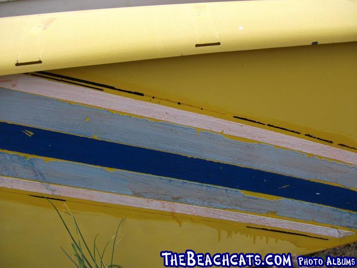

  • http://www.thebeachcats.com/gallery2/main.php?g2_view=core.DownloadItem&g2_itemId=72661&g2_
    i've had some luck with stubbern adhesives using a citrus based paint stripper called CITRUS STRIP. walmart used to carry it...still see it sometimes. test in a discrete place...if good then go for it. paint on a fat coat, don't brush back and forth, wait 20 mins or so, paint on another coat, wait til glue comes off in sheets(useually 10 mins). washes clean with water...didn't seem to affect gelcoats or aluminum...will mess up plastics!
