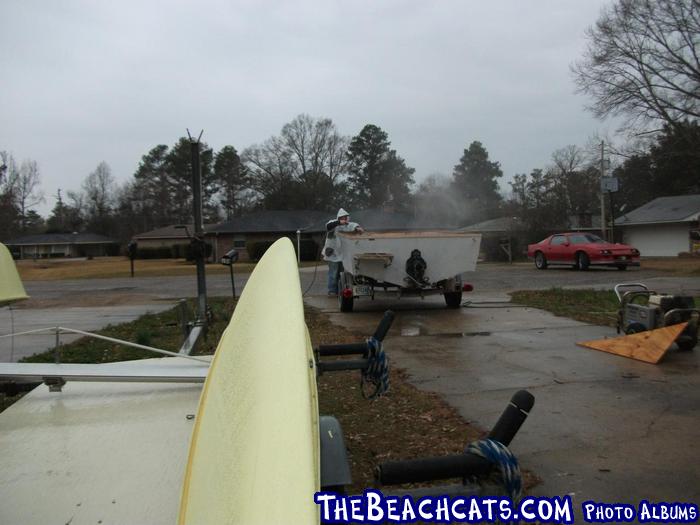

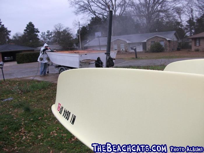

    got me some maintenace action this weekend also..
    http://www.thebeachcats.com/gallery2/main.php?g2_view=core.DownloadItem&g2_itemId=79178&g2_
    25 trips to the beach will sand off paint, gelcoat, and glass! never fear, west system is here...and a few ice colds to help process! new bearings for the trailor also...

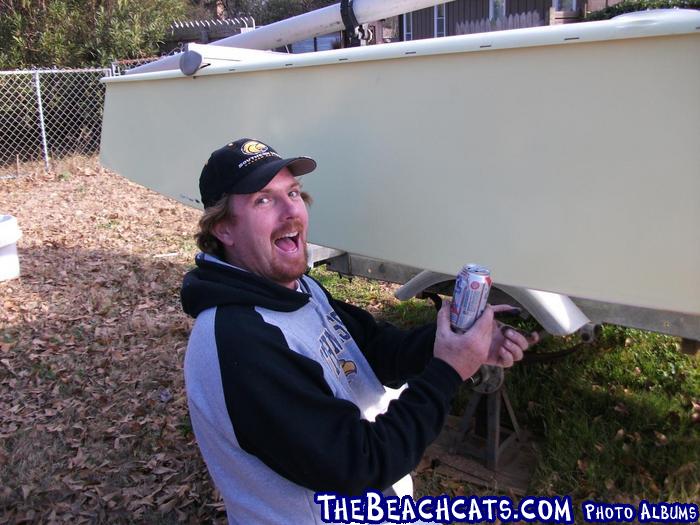

    keels ready for paint.
    http://www.thebeachcats.com/gallery2/main.php?g2_view=core.DownloadItem&g2_itemId=79211&g2
    keels painted...beer drank...
    http://www.thebeachcats.com/gallery2/main.php?g2_view=core.DownloadItem&g2_itemId=79207&g2_

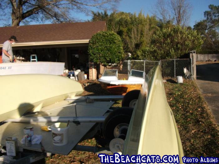

    might as well tear the criss craft apart too...this should only take a minute...

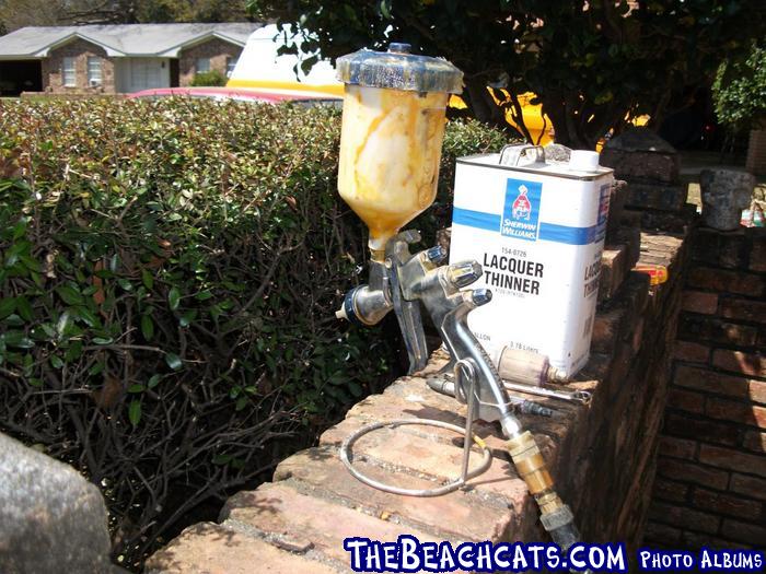

  • http://www.thebeachcats.com/gallery2/main.php?g2_view=core.DownloadItem&g2_itemId=72800&g2_
    doesn't need a primer for glass/gelcoat. ~40$ per qt.
    sprayed 2 coats last year and had 1/2qt left over.
    bought 15$ qt. reducer also.
    touched up keels with a brush, spit coat/top coat.
    loved the paint, it's a new product, we'll see how it holds up.

  • http://www.thebeachcats.com/gallery2/main.php?g2_view=core.DownloadItem&g2_itemId=72803&g2_
    i used the trusty gravity feed gun @ 35 psi...did great! this is a new product that is a hybrid resin blend. it touched up pretty good with just a brush. i regreted not putting more fresh glass on the keels last year, i just patched the deep spots and went with it. this time i did it right but if i hit the beach another 25 times or so this season i expect to work on the keels every offseason...the beach is one big 80 grit sander and is relentless.
    2 part products can be tricky when roll/tip applied, the back and forth motion of the roller in a shallow tray speeds up evaporation and can bring on an early set time shortening the pot life of the paint. hell, even spraying can sag/run the crap out of it. one good thing about living in mississippi(americas last frontier), is the complete lack of big government telling you what you can and can't do(OSHA,EPA) so my poor neighbors just suck it up literally. i live in the county where you can build a home with NO CODES OR INSPECTIONS any way you want...wild wild west style. now in the city of hattiesburg it's a little different, they require permits, standard building codes, inspections, and they even can make you clean up your funky yard!
