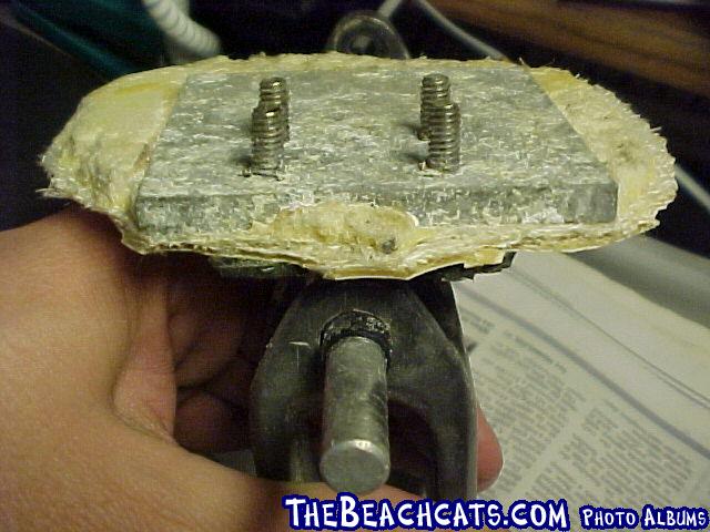

  • My H18 is loaded with stress cracks around gudgeons which I was thinking of repairing over the winter. Im curious on how the gudgeons are attached. I would figure with nuts and bolts and maybe a plate? If so, how am I ever going to reinstall the nuts?
    Is it simply screwed on? I really wouldn't trust threads in fiberglass after removing the screws and then reinstalling them.
    Should I just not worry about the stress cracks? My hulls are loaded with them but I dont think that grinding them out and smoothing in some marine filler is going to add any strength....

  • if you are talking about the rudder gudgeons, there should be an aluminum plate glassed in to the inside of the transom.

  • there is an aluminum plate glassed into the inside of the transom.

  • Here's some pictures showing the "inside story".
    http://www.thebeachcats.c…836&g2_highlightId=10850
    http://www.thebeachcats.com/gallery2/main.php?g2_view=core.DownloadItem&g2_itemId=27561

    That's actually my 1981 H18 in those pictures. grrr The damage happened coming in through the surf at Panama City Beach with old style rudder system that wouldn't release despite nearly tearing the tiller arms off trying to manually release. After that happened I spent the money on the rudder system upgrade.
    As far as fiberglass rudder pins I think they are a horrible idea, but one that sounds reasonable on the surface. The problem is that you are trying to solve a problem (rudders won't kick up) by creating an even worse situation in that you can lose the entire rudder system to the watery depths if you break a rudder pin.
    Fiberglass pins can break just from the pressure of fast sailing, and when one goes the other is right behind it and suddenly the rudders, castings, tiller arms, and cross bar are not connected to the boat at all. If you are lucky you might keep a hold of the tiller extension, but maybe not.
