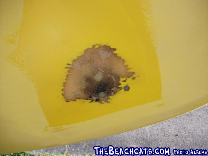

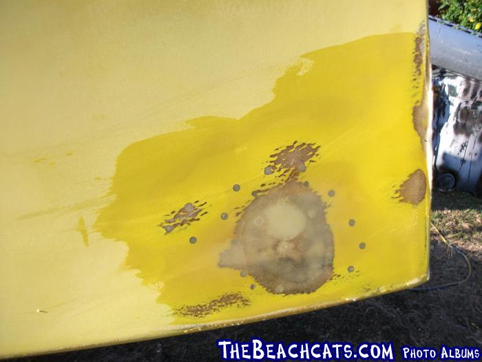

tap on the blisters and the surrounding area. a soft spot(de-lamination) will sound hollow noticeably. either way you will probably en up sanding off the blisters and "skimming" a pass or two of epoxy/sillica mix to fill voids and then touching up w/gelcoat. if de-lam, then injection trick along with sanding/fairing.this was a soft spot in my bow that was injected and skimmed and sanded to smooth for paint.
this was a big soft spot before and after icoat of paint.
