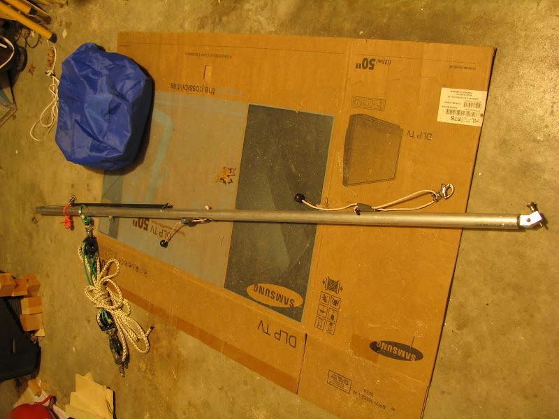

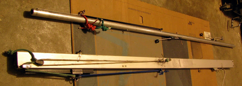

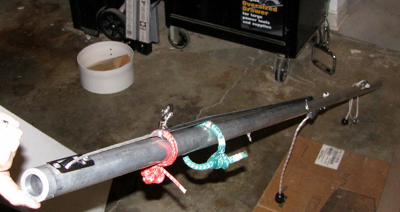

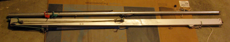

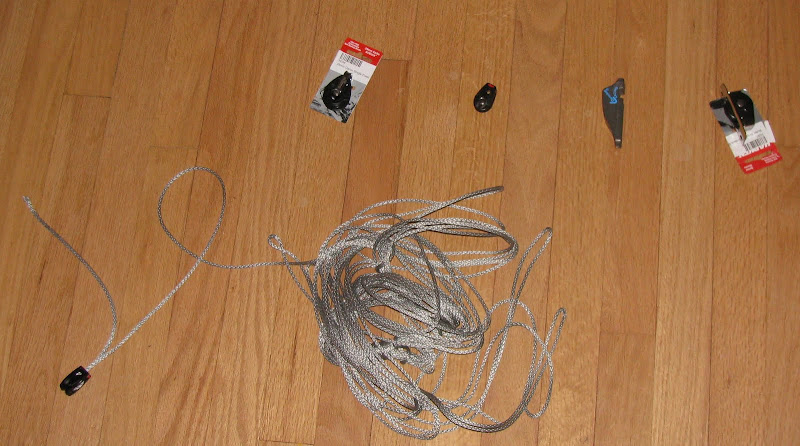

  • To clarify, I assume that on the modern cats the boom is used mostly for outhaul and mast rotation. I don't have one so I could easily be wrong. Here are pics of my tinkering..
    http://lh3.ggpht.com/_PPRkiYPDA_Q/S9W13WIEfcI/AAAAAAAAD44/sxW5GjBJWnI/s800/N5.2%20Boom%20001.jpg
    http://lh4.ggpht.com/_PPRkiYPDA_Q/S9W13tQI9qI/AAAAAAAAD48/6B71Y22YteE/s800/N5.2%20Boom%20004.jpg
    http://lh4.ggpht.com/_PPRkiYPDA_Q/S9W14Kg-VYI/AAAAAAAAD5A/K8aw_UvbvJ4/s800/N5.2%20Boom%2000112.jpg
    http://lh5.ggpht.com/_PPRkiYPDA_Q/S9W14pWBq0I/AAAAAAAAD5E/VdoKiOBBYV0/s800/BoomandBag%20002.JPG
    http://lh4.ggpht.com/_PPRkiYPDA_Q/S9W14_2DWpI/AAAAAAAAD5I/BJydV-dMqPM/s800/Outhaul%20-%20Parts1%20002.jpg
    I didn't use the basic 29mm harken in this pic.

  • Hey Rob,
    I was looking at doing something similar to my 5.2. What do you think about using an old sailboard mast for a boom? I have a couple of these kicking around, they aren't the super thin light ones they use these days, but mid 80's carbon fiber overbuilt ones. It would reduce some weight and make less of a dent in my head if it made contact.
    Do you have some closeups of the outhaul system you put together? How did you get 4:1 internally? i.e. what type of blocks did you use inside? That is definitely a project I would like to try out myself!!
  • I spliced two dyneema lines to the ronstan 20mms, with one luggage tagged to the snap shackle for the outhaul. Those two cascade, with a 3/16 sta-set line running through the last one and out through a thru-deck to the cleat. I can't really take a picture b/c its inside the tube. The outhaul actually runs very smoothly. I was a bit concerned about the soft shackles sliding well under load, but that doesn't so far seem to be the case.
    I have a notepad with the drawing I used to make it laying around somewhere...unfortunately I have more projects than sense and all the stacks of notes I CAN find don't seem to be related to this project.
    The trickiest part is probably the thru-deck in the center, since it has to go in after the two blocks with a line running through it. The 1.5" tube leaves zero extra room to work with lines around the blocks. It all has to slide in in place.
    The thru decks fasten to the INSIDE not the outside, so they are a little tougher than they look at first glance, but a little patience and LOTS of string got it done.
    I also takes a little planning to make sure that the paths traveled by the blocks don't interfere with the backs of the blind rivets...I mostly got lucky in this regard.
    The thick ring at the back of the boom looks nice, but it was a total accident and made it a bit tougher to manipulate the rear thru-deck block. I was trying to test fit my fittings (had a few chunks of aluminum machined, was an excellent idea) and accidentally press-fit one. About 15 minutes of sawing later and I had a smooth little ring on the inside, and a shorter fitting.

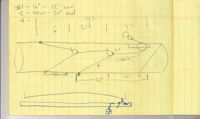

  • Here's the drawing I went off of. I'm fairly certain that the dimensions and scale bear no relation to reality.
    http://lh3.ggpht.com/_PPRkiYPDA_Q/S9ZZrYKrO-I/AAAAAAAAD6A/jDmLjmDer6o/s800/image0.jpg
    If there's a section of it you'd like a close-up on let me know. That might be more helpful than anything else.

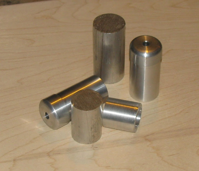

  • Here's the machined cap:
    http://lh4.ggpht.com/_PPRkiYPDA_Q/S9Zed00G-2I/AAAAAAAAD64/oYXCDdqXMG4/s800/alu%20cap.jpg
    http://lh5.ggpht.com/_PPRkiYPDA_Q/S9ZfOHB2qaI/AAAAAAAAD7A/S1l8FR2wdhg/s800/Aluminum%20Slugs%20005.JPG
    The shop that did them for me charges $45/hour or something like that, but this was a small enough job that I don't think it cost anything, but the dimensions came out a touch off, too...still got more than I paid for. I had to chuck the one I used in my drill press and wrap the belt from my belt sander around it. Took about 10 minutes of sanding to get what I wanted off of it. You can see the other one I sanded down and tried to test fit. Oops.
