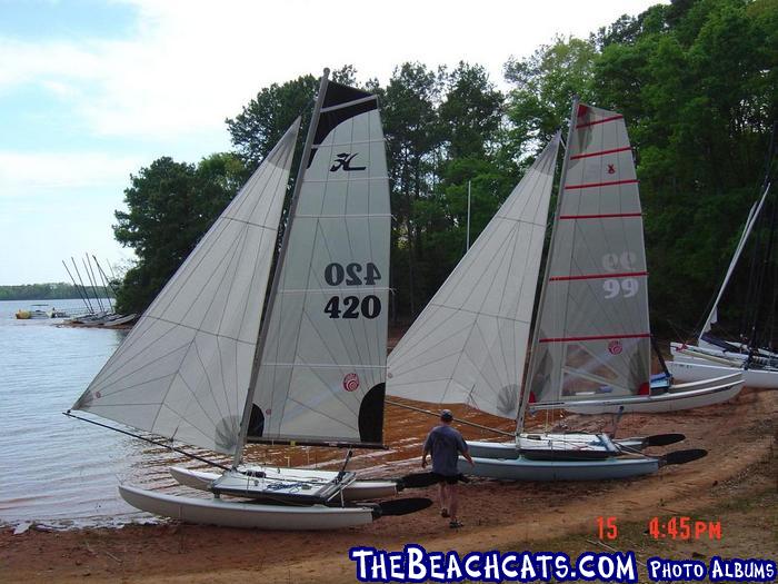

You can soup up a Hobie 14, there are a bunch of lightweight crazies who have created their own "14MX" class by putting square-head mains and spins on Hobie 14's.

Those are quite the set-ups. I don't know anything about "spin's" on a cat, I would have thought they were gennaker's up front. Googling now, but if anyone has a good link that would be great. -

Like Andrew said, the terminology of modern "pole mounted" head sails has a lot of overlap.
Those in the picture I'm pretty sure are furling headsails. More common on beachcats is the spinnaker snuffer systems. But the spinnakers used on cats with snuffers are almost as flat as those shown.
The snuffer bag hangs under the pole and holds the chute ready to launch, no packing.
The snuffer systems get the sail up and trimmed really fast, like magic.

Yeah, the one downside with Cats is that they are a little slow downwind (at least compared with reaching performance). Tripling your sail area with an assymetrical spin makes up for that in a huge way. Code 0's or hooters, like on the H14s above were pretty popular when the spin rigs were less well developed. Now they have fallen a little out of favor but because you can't go as far downwind with them. They are still viable and tend to be a slightly simpler setup once everything is put together (less rigging to deal with on the tramp).

I have no connection, but it looks like one of the H14T with a hooter is for sail on ebay. Looks like one of the ones from the pictures Damon posted above.
I think that boat would fit your criteria fairly well.

Thoes are the same cats #420 #99.... I'am surprised he doesn't have any bids on it yet~~~ NO I can't, I already have a 17 & 18...... but havin a 14 like that!!! HHMMMM?
