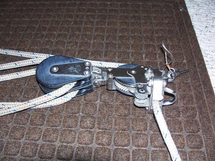

  • Correct! the main sheeting line attaches the boom to the traveler car for control purposes, there is a camcleat on the mainblock....http://www.thebeachcats.com/gallery2/main.php?g2_view=core.DownloadItem&g2_itemId=63051&g2_
    but it is hardly used as a gust couild have you over in a jiffy, so when trapped out, the main sheeting line is held in one hand, the tiller in the other and you rely on your trap wire to carry your weight. If you loose your grip on the main sheeting line the cat depowers instantly dunking you into the water. On gentle breeze days, mainsheet is cleated off, body is stretched out on tramp soaking up the rays, or sweltering, whatever the case may be. There is no backup, perhaps one of the other more experienced sailors could explain why...... icon_confused

  • check out how to thread your mainsheet through the blocks at.... http://www.thebeachcats.c…pictures&g2_itemId=63029
