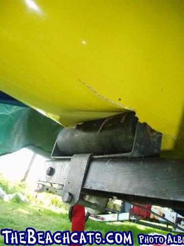

    Not being an engineer I like pictures to illustrate a point.
    http://www.thebeachcats.com/gallery2/main.php?g2_view=core.DownloadItem&g2_itemId=47440
  • There ya go Admiral, make sure you distribute that load!! 2 old rollers won't cut it! That would be a miserable repair!

  • Damon, thanks for using my pict of the crushed hulls from my Hobie 17, located in one of the wonderful snow belt parts of NY !! The rollers came off that year and I put bunks on the trl (2x10x10' w/rugs & 2x4 guides) All of the things that was mentioned for protection of the hulls on the ground is pretty good~ (so he can do his trl work)...
