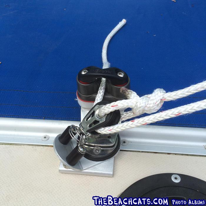

    Using the stock jib setup on the 5.0 is a PITA whether setup 2:1 or 1:1. Either way the block won't standup such that you can release the jib in light to moderate air, it's only in the OK category in a blow. I even tried using standup springs (not supplied OEM) with less than satisfactory results.
    Here is the stock setup that flops around.
    http://www.thebeachcats.com/gallery2/main.php?g2_view=core.DownloadItem&g2_itemId=29670&g2_serialNumber=4
    Here is the custom setup I use rigged 2:1 but I now run it 1:1 all the time no problem. With the swivel cleat you always have the cleat constrained and oriented such that it can be easily set or released.
    https://www.thebeachcats.com/gallery2/main.php?g2_view=core.DownloadItem&g2_itemId=132540&g2_serialNumber=4
  • leeboweffect
    MN3It is my understanding the 2:1 jib sheet set up is more about holding the (stock) jib blocks in the correct angle when in use than the mechanical advantage.
    without the jib block secured at the head of the block via the becket it could pivot around and make cleating an issue
    Looks to me NacDaddy uses some deck mounted cleat and not the stock cleat/block setup i see on most beach cats
    This block has no jib sheet tention and is not sitting in its actual position while being used - of course it flops around
    i have not used a jib block spring in 15 years - they do nothing of value for me.
    using stock jib blocks works for most of the people who sail beach cats -but if you find it problematic and have a better solution (or one that works for you) - cool beans
    where there is often an issue is the angle of the block. what works best for skipper doesn't always work best for crew and vice versa - and those little adjustment screws often get seized up after decades of use or non use

    Just to clarify, this is not the stock set up! That is my setup, which I reversed the cam upside down, which improves the angle for release on an NA version Nacra, which has a large jib, which needs 2:1 to manage. The image has been in my album for over 16 years:
    https://www.thebeachcats.…2928eef1585bf7f66ac79947
    https://www.thebeachcats.…b55535cdd0724e92f5d06ddd
    In light air the sheet is in perfect position to manage and the spring works perfectly. The spring also prevents the lazy block from twisting/tangling.
