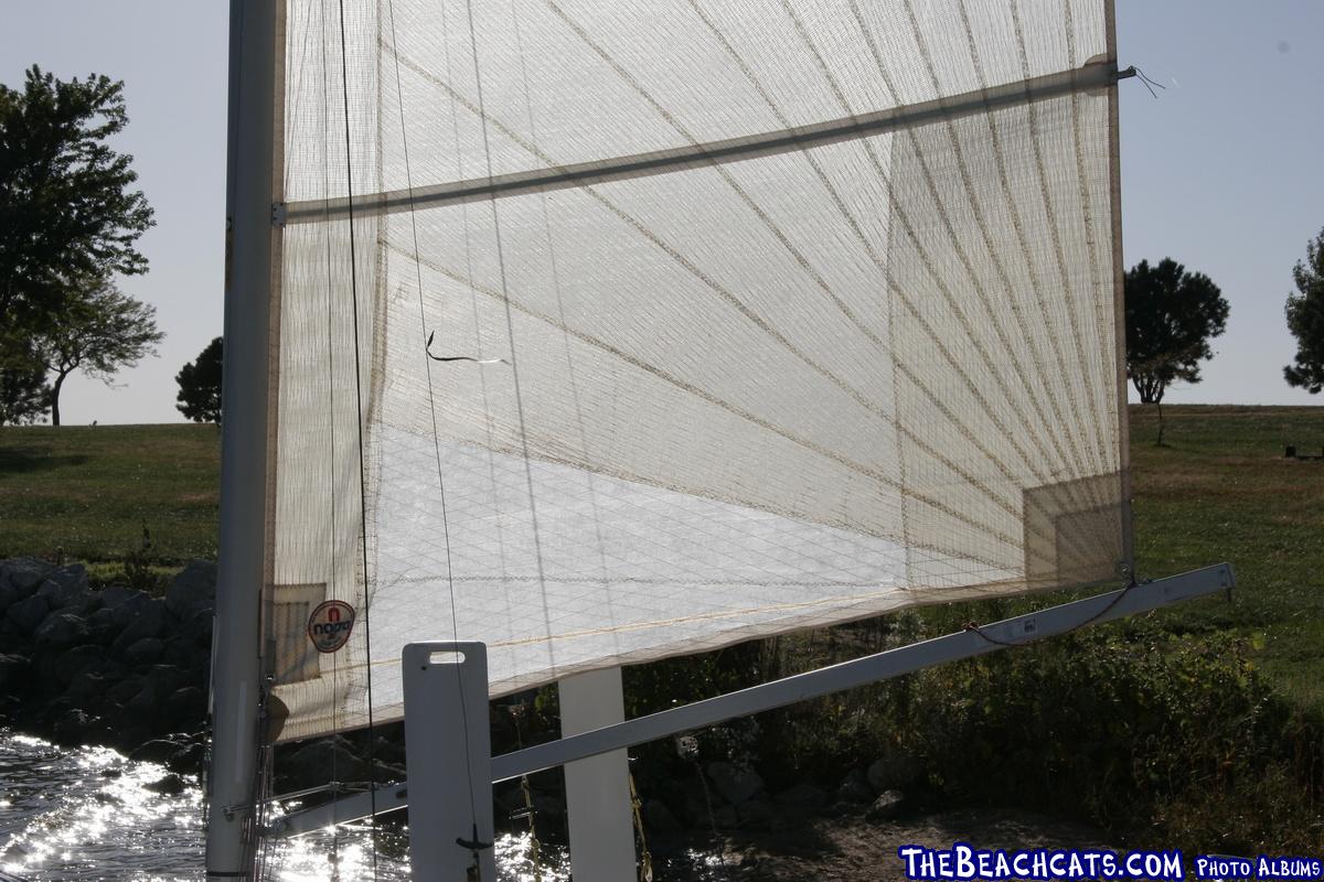

i had a tear in this mainsail that was caused by my crew hitting the sail to get the battens to flip during a tack. I repaired the 8" tear with LifeSafe Clear Sail Repair tape. see if you can find the location of the tear in this photo?
j
