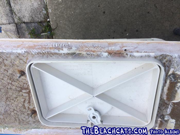

  • inside my deck:
    maybe i will add some backing plates to those bolts
    http://www.thebeachcats.com/gallery2/main.php?g2_view=core.DownloadItem&g2_itemId=124135&g2_serialNumber=4
    Nothing like intimately knowing the inside of your boat
