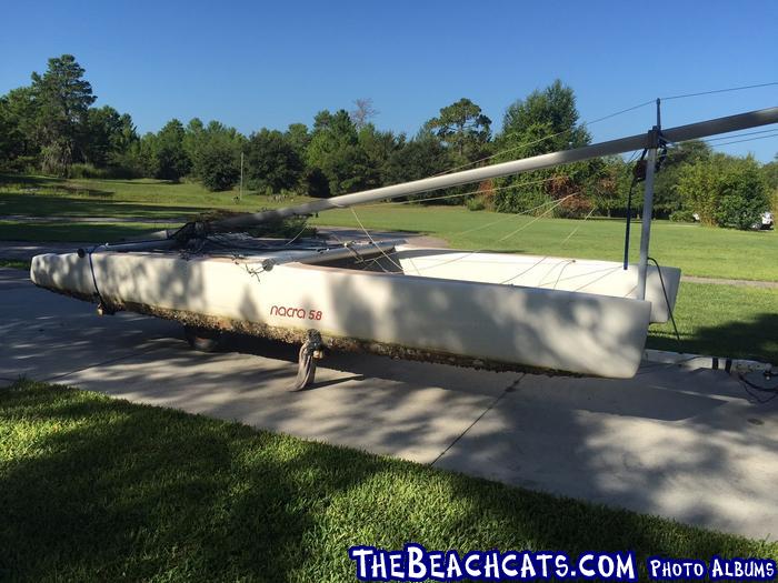

  • I just picked up a 82 Nacra 5.8. Bit of a project but not too bad, hulls are in good shape. Original sails look like new. Hulls had a couple places needing some glass work. One daggerboard was in good shape the other one needs to be rebuilt and is in process. I'm going to re-gel coat the boat next. I have been around sailing quite a bit but never owned a cat. I will need some help at some point with rigging, specifically main downhaul and mast rotation setup. I think I have most of the rest of the basic setup covered. But that will be a little while yet.http://www.thebeachcats.com/gallery2/main.php?g2_view=core.DownloadItem&g2_itemId=124519&g2_serialNumber=4
    This is an older picture of the boat.

    Boat was sitting in the water for about 8-12 months. Barnacles and oyster growth in hulls and in the dagger board openings, oysters are a pain to remove fyi. Hulls are in good shape now.

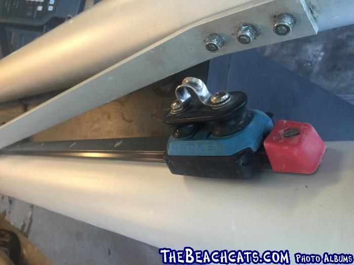

    Had that "oh shit" moment when you realize the main traveler just ran off the end of the track and all the bearings ran for the hills. Managed to find 39 of the 40 little bastards though and got them back where they were supposed to be...

  • QuoteManaged to find 39 of the 40 little bastards though and got them back where they were supposed to be...
    you will quickly kill the other bearings with the wrong amount (over or under) of bearings. I would recommend repacing the lost one before sailing

    Quote Managed to find 39 of the 40 little bastards though
    What type of car do you have?
    Is it a Harken, using the 1/4" (I think) Torlon balls?
    I'm thinking yes, that sail pattern is the same as mine '84. I can't remember when they changed fro the Kenyon car, with 1/8" steel balls. They came with either two tone blue pinstripes, or orange/red.
    You can buy the bearings at any dealer, in bags of around 10. If you only need one, I have a bunch, I can mail you one. The non-captive cars are easiest to get back on with a "loader, or short piece of track.Use shaving cream in the car to hold everything in place while you slide the car back on.

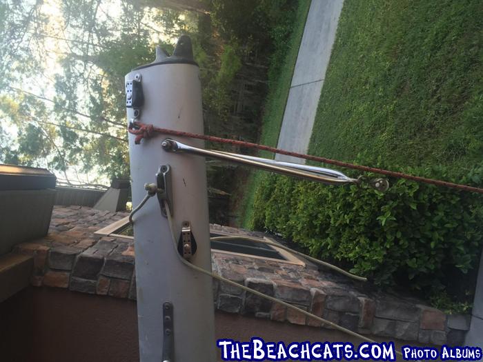

    The mast rotator is the other question I have, if you can weigh in on that, there is one pulley on the wishbone and each side of the cross beam has a the same hardware.
    http://www.thebeachcats.com/gallery2/main.php?g2_view=core.DownloadItem&g2_itemId=125573&g2_serialNumber=4
    The traveler is a Harken with the torlon balls, I'll add a couple to the next order I make at Murray's.
    http://www.thebeachcats.com/gallery2/main.php?g2_view=core.DownloadItem&g2_itemId=125579&g2_serialNumber=4

  • QuoteThe mast rotator is the other question I have, if you can weigh in on that, there is one pulley on the wishbone and each side of the cross beam has a the same hardware.
    You just need a bit of line. I removed the rotator from my 5.7. It was useful downwind, but I'm not racing, & so don't care about an extra minute. It was also useful to prevent the mast from flopping around in flaky wind & shaking the air out of your sail. However, you must remember to release it as your first item. If you don't, you risk breaking the mast in big wind. If you are in a hurry to get on the water, ignore it for now, the boomless rig will self rotate except for downwind. I initially rigged like this;
    http://www.thebeachcats.com/gallery2/main.php?g2_view=core.DownloadItem&g2_itemId=74457&g2_serialNumber=7
    That is a pretty crappy way to rig it though. Later on I went to a continuous line. Deadend at the eyestrap on beam-to end of rotator- back through cleat- around behind mast-through opposite cleat-to rotator-deadend on eyestrap.
    That gives 2:1. I think i used 1/4" line, there is a fair bit of twisting force, & the 1/4" was easier on the hands.
    That looks like the exact car we use on the 5.0, the 5.7 has one almost twice as long. From the end stop it appears to be the "non captive" type of car, as you discovered! Make sure the car/bearings are clean, & DON'T OVERFILL the cars with bearings. I think you can get 1 extra ball in there.
    Here is some info, scroll to bottom.
    http://www.harken.com/traveler/
    Maintenance-note, you don't need expensive One Lube, a drop of 3-in-1 oil works. Personally,(freshwater) I don't use anything.
    http://www.harken.com/uploadedFiles/Product_Support/PDF/4970.pdf
    Identify your car;
    http://www.harken.com/upl…ct_Support/PDF/M1012.pdf
    Make sure you tie a stopper knot in your traveler line so the cart cannot quite reach the end of the track. If it does slam over, it will shear off that little stop & fly off the track. You won't lose the car, it's on the line, but all the bearings will become fish food.

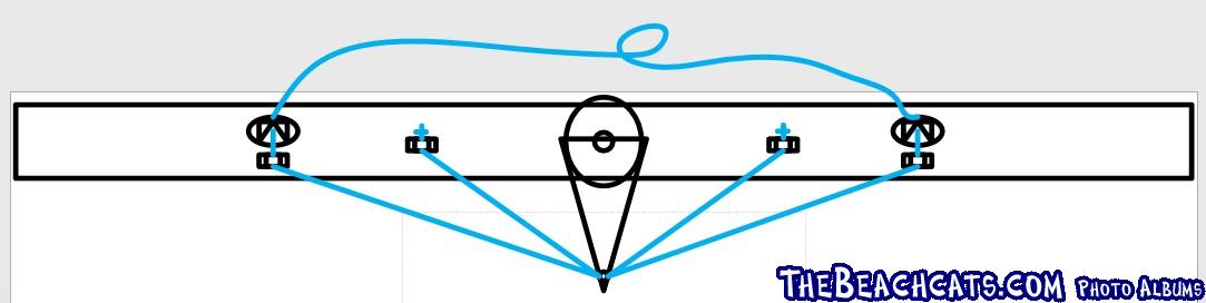

  • If I follow it, this is what you were describing, does this look right?
    http://www.thebeachcats.com/gallery2/main.php?g2_view=core.DownloadItem&g2_itemId=125595&g2_serialNumber=3

  • todd1016If I follow it, this is what you were describing, does this look right?
    Yes, and you don't need turning blocks, just some 3/16" line and you're good to go. Ed's spot on on the rotator and downhaul. Now if you want to trick it out, get an over-rotator and 16:1 downhaul. You can see pictures in my album doing it both ways.
