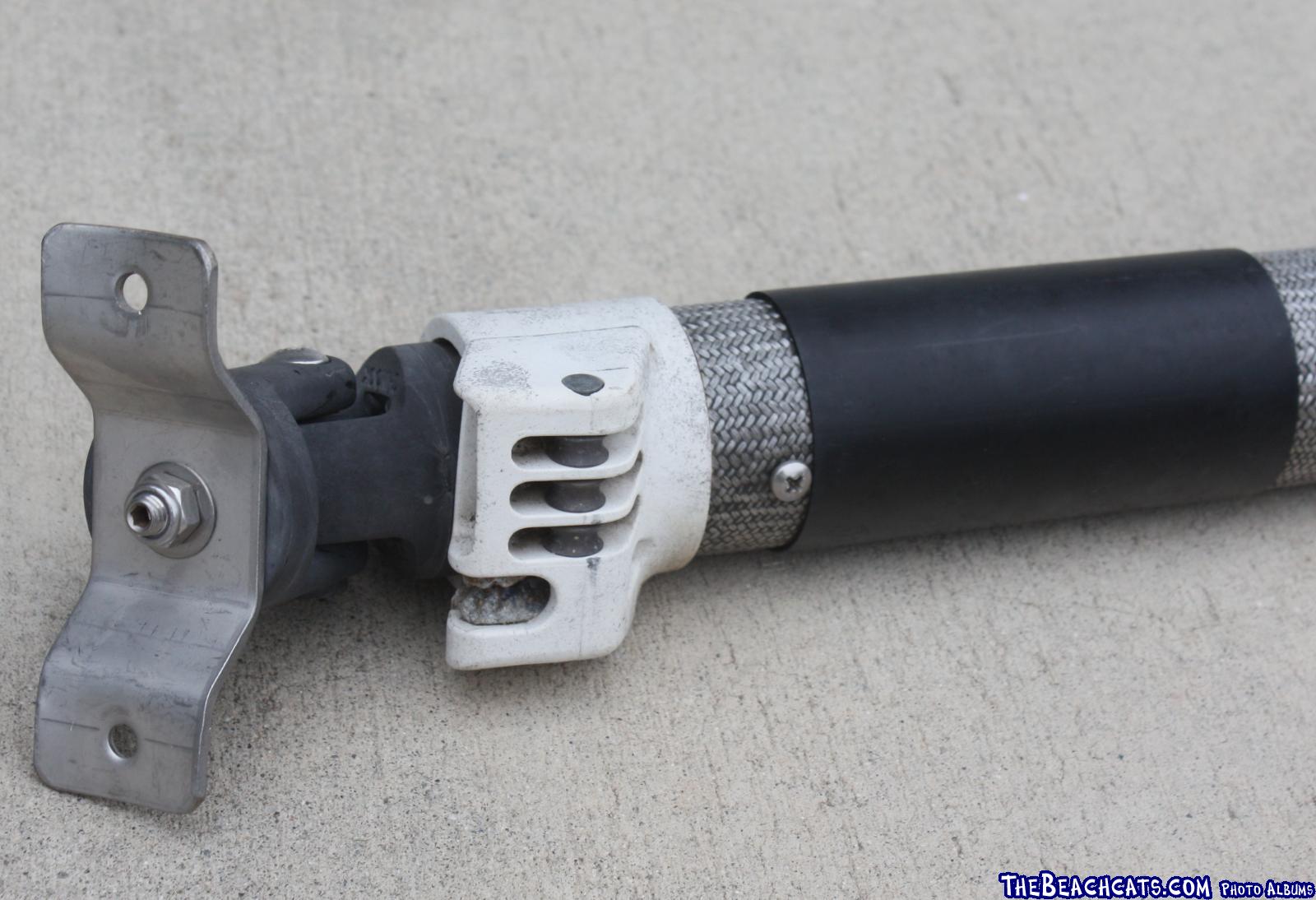

  • A righting pole by Techofiber came with my boat. There is no information on their website on how to install. One end looks like it bolts to the boat.
    http://www.thebeachcats.com/gallery2/main.php?g2_view=core.DownloadItem&g2_itemId=107217&g2_serialNumber=3
    I don't know if this bolts to the bottom of the v-bar on the dolphin striker or to the bottom of the front crossbeam. I'm not sure I'm comfortable drilling into either, as I don't want to compromise the structural integrity of each.

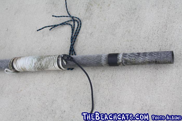

    The other end has a line wrapped around it that ends in an eye strap.
    http://www.thebeachcats.com/gallery2/main.php?g2_view=core.DownloadItem&g2_itemId=107220&g2_serialNumber=4
    I'm guessing this is hooked back into the boat somewhere, but most of the videos I've searched show a line attached fore and aft making a "V" so the pole doesn't rock. Lastly, the end of the pole looks like it has a smaller tube telescoped inside of the larger one. I've tried twisting it to loosen, but no joy.
    Any suggestions on how to assemble and route the line?

  • Mos def to the front crossbeam. A PB Blaster treatment will probably loosen up the telescope fitting.

  • The righting pole on my Stealth is attached to the aft side of the main beam, on center. Mine extends a couple of inches aft of the rear beam, and is secured with small dia. bungie, which allows for quick deployment and reattachment after righting, as well as letting the pole deflect downward when it's stepped on from above the tramp when crossing.
    I've got four loops of vectran around the ends of the beams where they meet the hulls, and on the ends of the two lines off the outboard end of the pole, are a couple of snaps that clip to the appropriate loops, one line is shorter than the other, keeping the pole tip more forward than if they were equal length(which keeps my righting force more in line with the mast). The length of these lines keeps the pole tip well above the centerline plane, and I hang from the very end with my hands, and wrap my legs around the pole to keep myself out of the water.
    When the boat is righted, I quickly unsnap the two lines from the loops, and when the boat starts moving fwd, the pole trails aft, and I can reach down and grab it and flip the loop of shock cord over the end. I usually just pull the lines up over the rear beam and clip them to the tramp lacing somewhere until I can park the boat and tidy things up.
    My pole is a carbon windsurf mast with a fairly std universal joint, and a metal brkt like the one you have pictured, held to the main beam with a couple of small dia s.s. rivets. I doubt drilling these two holes has a significant impact on the beam strength.

    I use very similar setup. I attached the mounting bracket like yours to the aft side of front cross beam. To do that, I manufactured 3/4"W x 1/2"H x 6"L aluminum bracket with 2 threaded holes. I used a sail batten to push it inside the cross beam in premeasured position. I drilled 2 thru holes into the cross beam. Then I simply bolted with 5/16 screws (I also used LockTite on the threads).
    Daves set up I think is similar or the same to this one:
    http://thebeachcats.com/pictures/?g2_itemId=79873
    I also use the vectran line, spread from the end of the pole to end of the front cross beam (eyelet) to other end of the cross beam (another eyelet) and back to the end of the pole (eyelet). I don't use clips, I riveted a cleat to the end of the pole, which allows me to move the pole up, parrallel to the mast.
    I also have another line with bungee at the of the pole and secured to the back cross beam to pull the pole up from the trampoline. The extra line is stored in the trampoline lacing.
