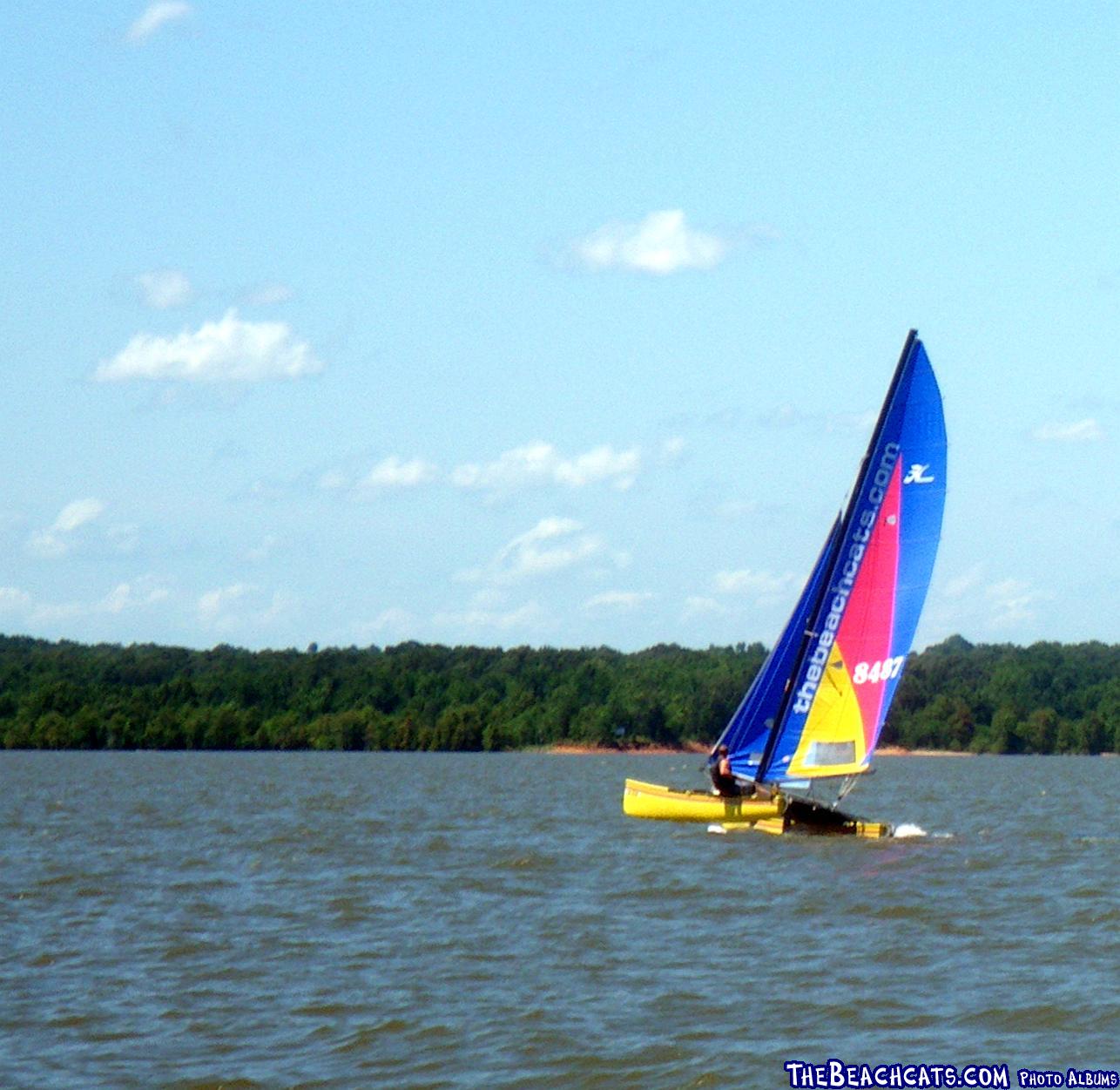

    If the hulls are "original" and not repaired, then the yellow can really pop with some elbow grease or chemicals (Poli Glow).
    http://www.thebeachcats.com/gallery2/main.php?g2_view=core.DownloadItem&g2_itemId=80727&g2_serialNumber=3
