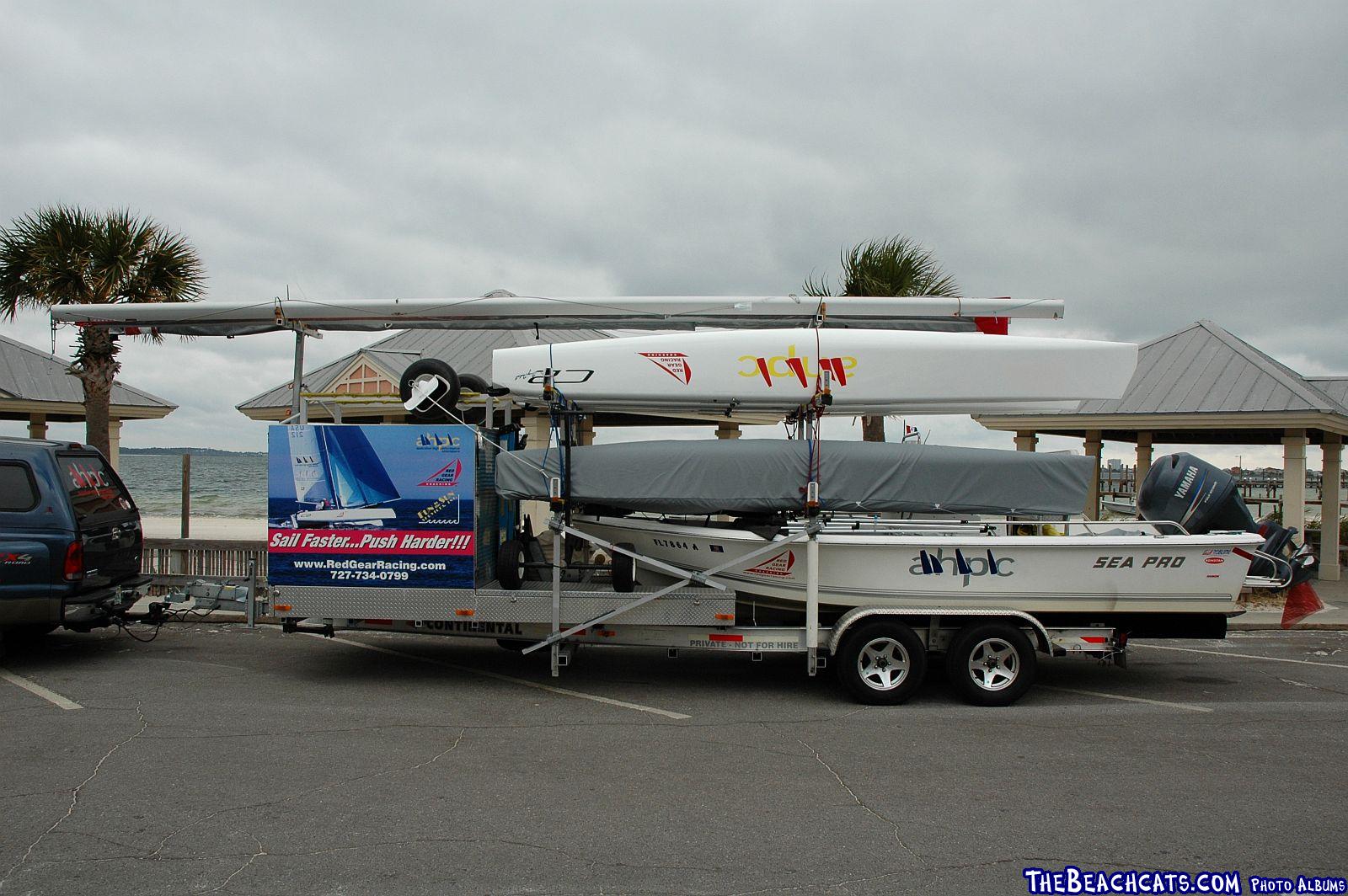

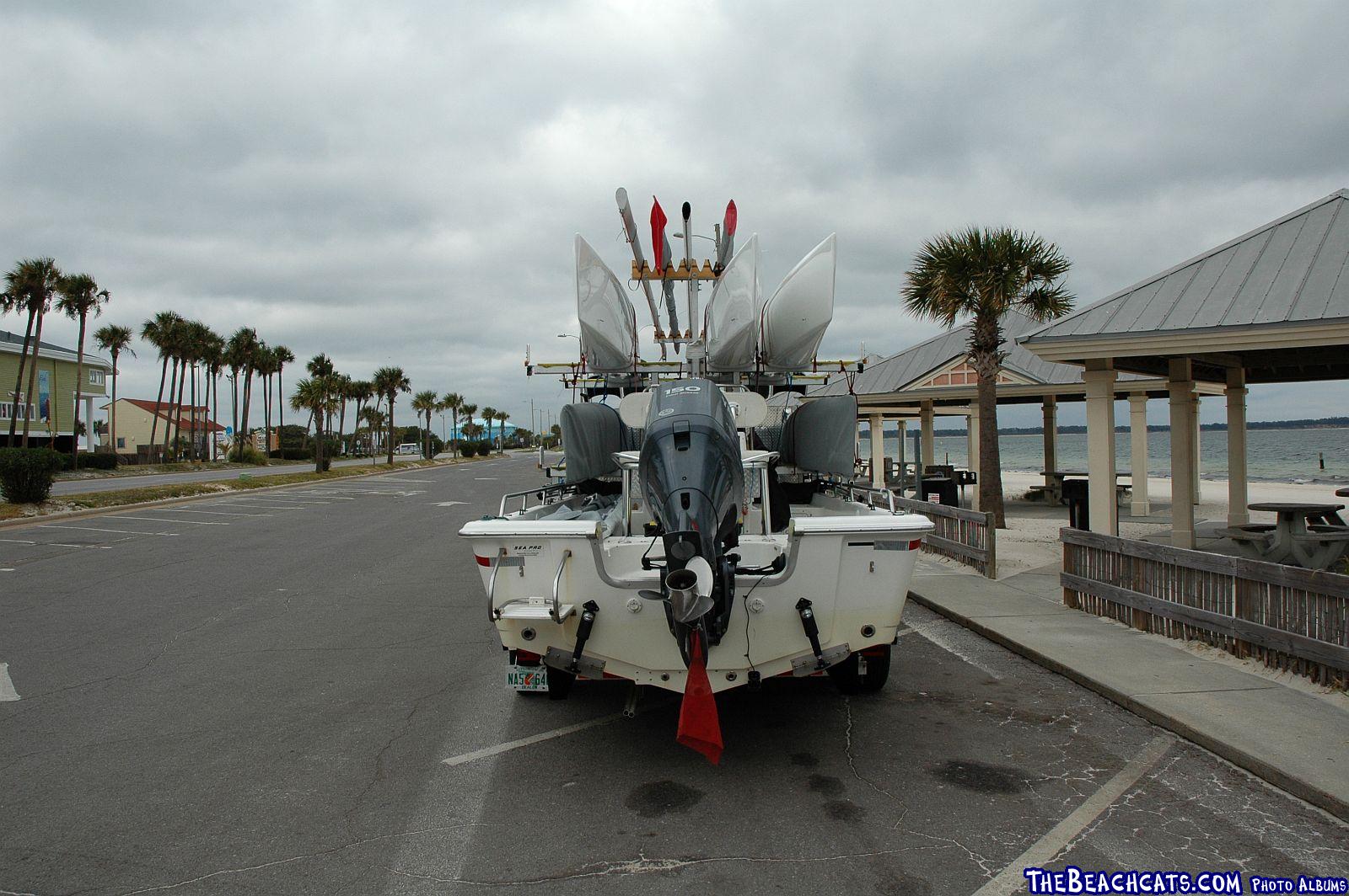

  • fxloop i'd love to modify one of my H16 trailers to accommodate my cat and my seadoo when there's no wind. Can this be done?
    All you need is something like this rig Robbie Daniel uses when doing his clinics. So get on that!
    http://www.thebeachcats.com/gallery2/main.php?g2_view=core.DownloadItem&g2_itemId=96453&g2_serialNumber=3 http://www.thebeachcats.com/gallery2/main.php?g2_view=core.DownloadItem&g2_itemId=96461&g2_serialNumber=3
  • I like his RV too - it is a full on sailing shop....
