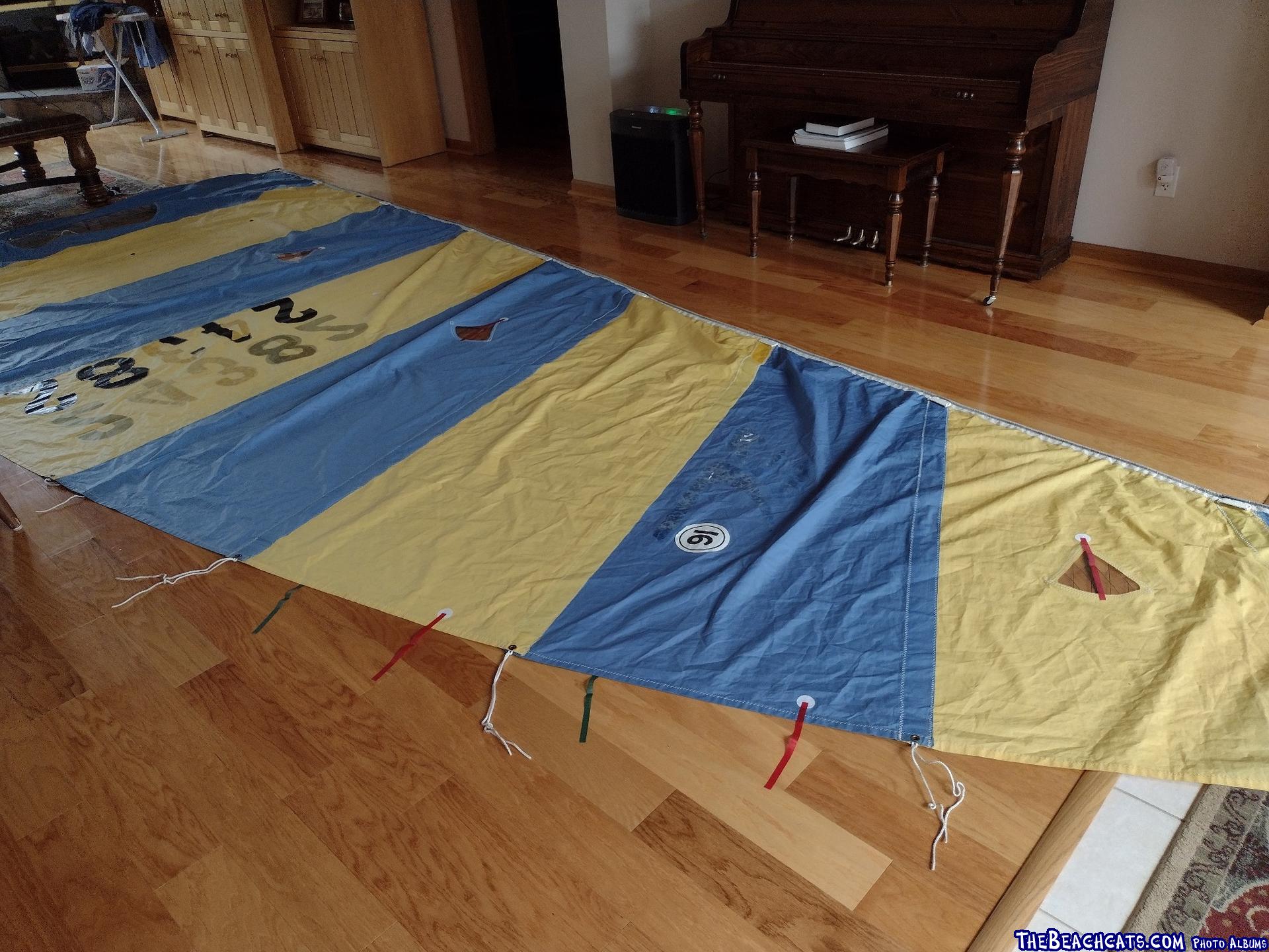

  • I liked the human outline idea but I got lazy. Here is my jib:

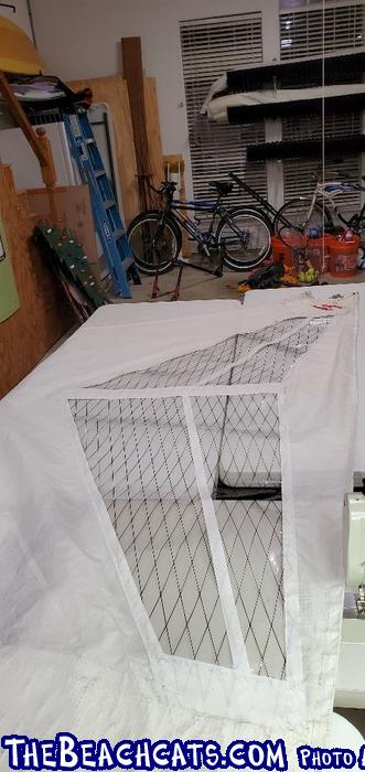

  • Since you're showing pics of your kids...Here's mine, trying to match the radial panels of the jib window I was replacing. I think this window's too big, but it's what was original and destroyed:
    https://www.thebeachcats.com/gallery2/main.php?g2_view=core.DownloadItem&g2_itemId=136687&g2_serialNumber=4

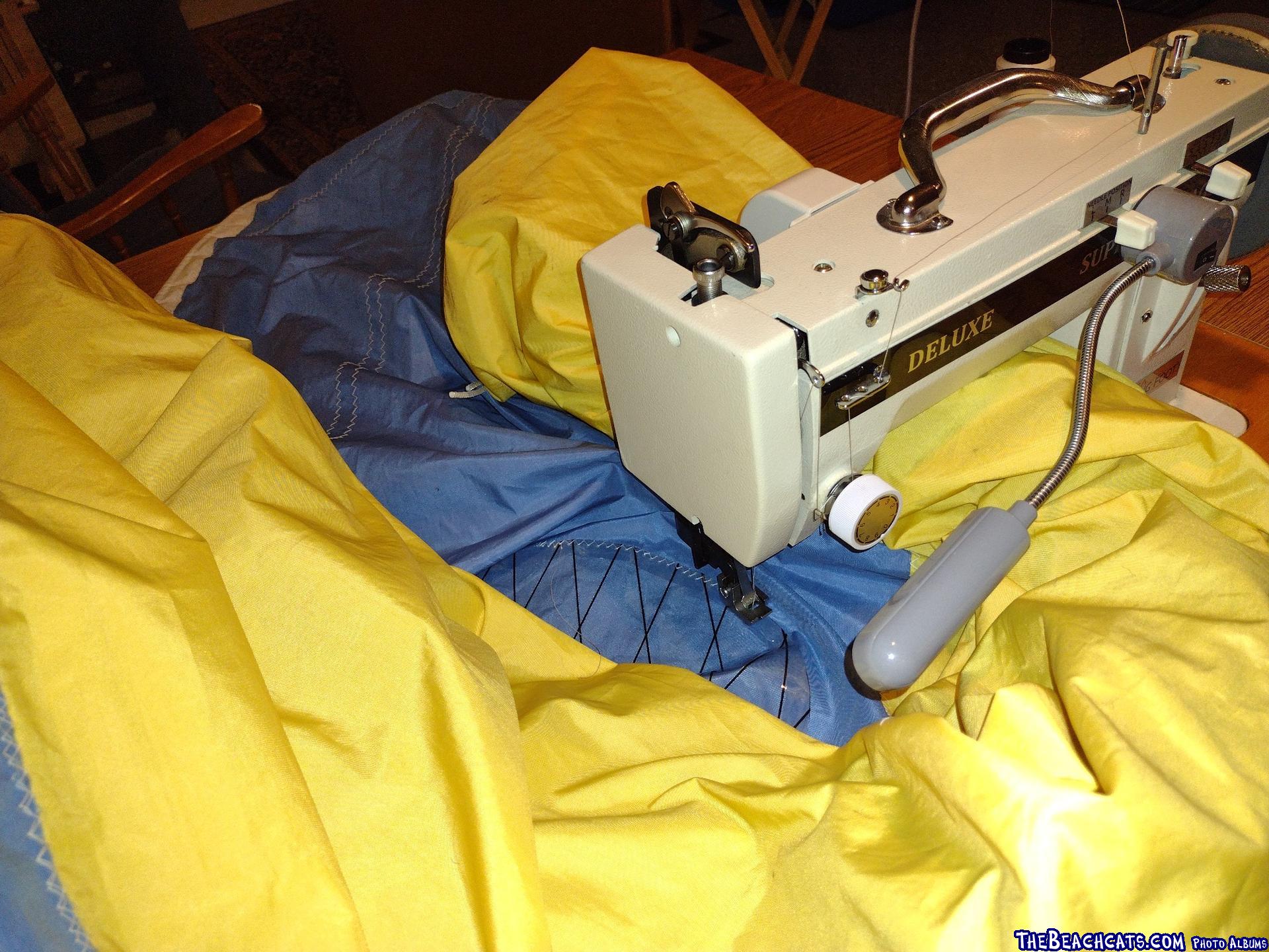

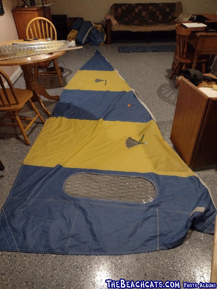

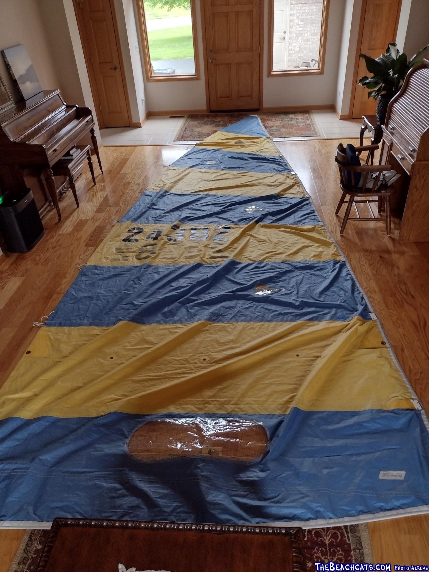

  • Chuck, I'm glad you told me about the Omega machine with the 2" inches of space. Hard to jam that sail in, would have sucked on a smaller machine.
    https://www.thebeachcats.com/gallery2/main.php?g2_view=core.DownloadItem&g2_itemId=136696&g2_serialNumber=3
    Main window. The transparency ends were cut out with a 1' diameter, and the height before sewing was 1'. That was the pattern I had for my sail bag that I made.
