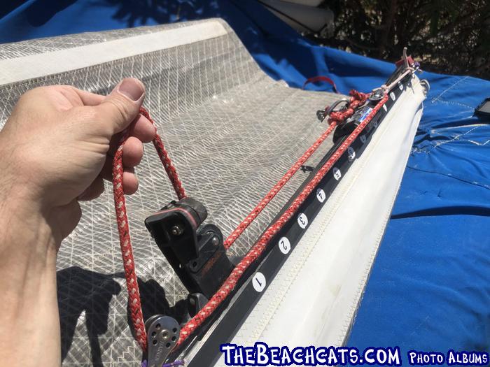

  • The line controlling the car on the sail track tends to get tangled with the mainsheet system. I never had a problem but I don't like it. I thought of a simple solution, if it works. Unfortunately I couldn't test it because of the tsunami alert. I just tied a short length of bungee to keep the end of the line up. Anybody has done something different for this?
    Here is a not very clear picture.

  • Yes, that could work. Instead I would try sewing a pocket on the sail to store the line. Another idea is to use a longer line, add small blocks at both ends of the track and run the line to the aft end and back to the car, using the same purchase on both sides of the car. That would keep the length of the loop constant and it could be set smaller than a head diameter.. With a system like that I would change to a 1:1 purchase, for simplicity and less friction.
  • I had initially thought to add a pocket to the sail with a bungee retract, but I think the bungee might end up unintentionally pulling in on the line when you have the blocks set at the back of the track.
    I like the continuous loop idea, I think that would be quite clean.

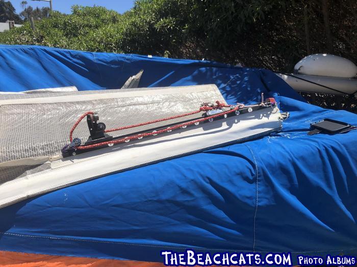

  • I set up the continuous loop and it looks good. My system doesn't run smooth, it needs some maintenance, but it still works. I added a bungee take-away on the aft end, or otherwise the horizontal lines would be loose and it would still be risky. With that I lost about a 10% range but I never go all the way out.
    Thanks dogboy for the co-creation:)
    https://www.thebeachcats.com/gallery2/main.php?g2_view=core.DownloadItem&g2_itemId=136242&g2_serialNumber=4
    https://www.thebeachcats.com/gallery2/main.php?g2_view=core.DownloadItem&g2_itemId=136245&g2_serialNumber=4
